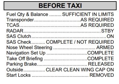

From Perimeter SA-227 Normal Checklist, Revision 9. Start Locks is now a separate check.

throwaway23 wrote: Wed Jul 28, 2021 1:45 pm From Perimeter SA-227 Normal Checklist, Revision 9. Start Locks is now a separate check.
Couple of odd things on this checklist IMO. Maybe a Perimeter person could explain.
What is the difference between a "clear clean wing" and a "clean wing"?
Do you really need "Parking Brake Released" on a Before Taxi checklist?

airway wrote: Wed Jul 28, 2021 9:55 pm
Not really. Just as well do it on the Lineups. If you get that far.

cncpc wrote: Thu Jul 29, 2021 11:00 am
Yes you do.
It could be a “killer item”.
https://www.tsb.gc.ca/eng/rapports-repo ... q0087.html
'clear' is about the prop area, not the wing.
Another example of checklist inflation?
Yes you do.
OK, I guess on the Metro it is important :shock:
Poor design if you ask me.
Shouldn’t you have checked that the prop area was clear before starting the engine? If it wasn’t before, it probably is now!
Oh, absolutely. Completely agree with you. Just explaining what is (likely) meant by the checklist item.
Checklists only ever grow, they never shrink.

The checklist we are discussing is done after both engines have are running.
When you remove the props from the start locks it is a blast of reverse and then they blow a lot more air backward compared to when they are on the locks. You want to make sure your ground crew has disconnected the GPU and cleared the area. It’s been 10 yrs but that is the gist as I remember it.

It is on the Jetstream as well.
As for start locks, I remember that as being one of the last items on the Before Taxi checklist. In my last job working for someone else, I had to write up responses to at least 3 CADORS for rejected takeoffs where that item was missed, the taxi and takeoff run were carried out with the props still on the locks. That led on to another incident, not reported, where the aircraft was near V1 and the FO called Reject where the speeds were not right. The pilot doesn't reject, but slams the throttles backward over the gate, does whatever else is involved in bringing them off the locks, and then rammed the throttles forward and continued the takeoff. That raised some eyebrows.
