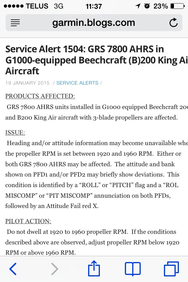

Re: What does prop rpm have to do with AHRS?
Like I said, ignorance.
Who cruises a B200 at 1900 RPM? Your pax must love it
Isn't 1900 RPM used for climb? It's been years since I've been in a 200
Yupleftoftrack wrote:Isn't 1900 RPM used for climb? It's been years since I've been in a 200
So can we not deduce from that, that maybe the plane was in the climb. Flight aware actually shows it if you look. 1900 rpm is the climb rpm in a king air. 1920-1960 is the "danger zone".

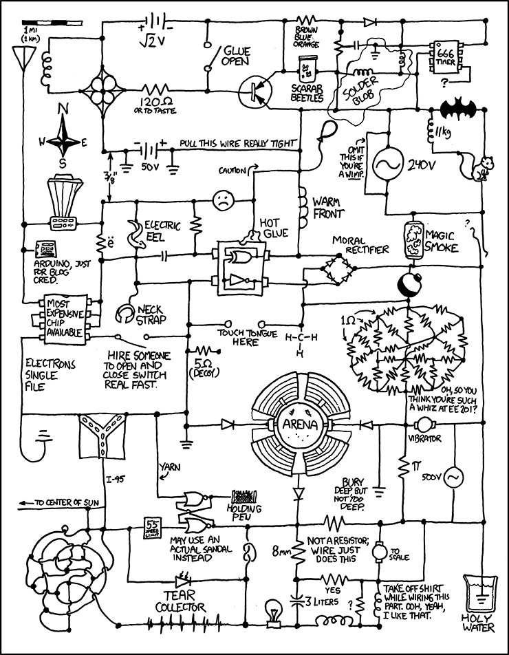

Jesus, tough crowd. Look, I've included a diagram that shows direct correlation between the AHRS and the propeller rpm. Instead of bickering maybe take a moment to edumacate yerselves!
I found the problem, thanks Toeless! The moral rectifier is directly connected to the magic smoke! No wonder the AHRS is squiffy.

A strap-down gyro is different than a typical gimballed gyro in that its movement is restricted. Instead of measuring the displacement between the gyro and gimbal a measurement of the forces of the restricted gyros are taken. This force is proportional to the angular rate of change along the gyro's access.
Also keep in mind that the Garmin AHRS is slaved outside of NDA so the problem may be with the flux detector.

I am fairly sure that the garmin uses "tuning forks" not gyros that sense acceleration by the change in frequency "doppler effect, they have 3 for the different planes run thru a mixer " computer" translating to a signal for the display. it is conceivable that the natural oscillation frequency had some resonant effects at the 1920-1960? rpm. Some light reading to the concept.
http://www.pprune.org/tech-log/print-33 ... -86-a.html
http://www.avweb.com/news/features/mems ... 787-1.html
http://evaluationengineering.com/articl ... course.php
