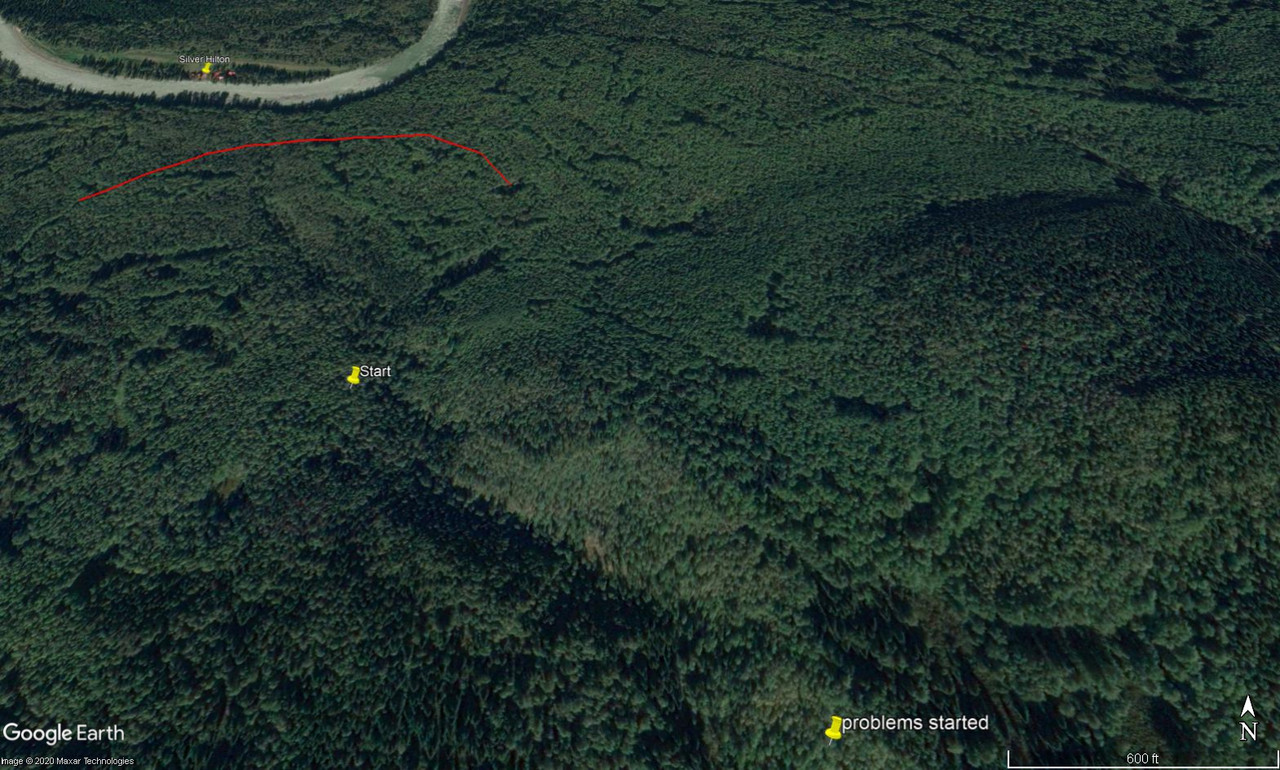

It's a puzzle as to how the pilot didn't know where Silver Hilton strip was.
This Google Earth image is taken from an eye altitude of 5200 feet, from overhead one of the dots on Figure 2 as the pilot headed out on the track that ends at the accident site. It seems from the conversations that he thought he was 5 miles west of Silver Hilton when he radioed that he was unable to reach and would land in that spot.
The pin at the bottom right side of the photo below marks perhaps 30 seconds after the first call at 8:32, in which the pilot says he was going to land at Silver Hilton. The eye elevation is 5200 feet, close to the altitude the aircraft would have been then. Silver Hilton is plainly visible then, one mile away. So, when the pilot said he was going to land at Silver Hilton, the strip was right in front of him.
The Start pin marks the location of the survey run when it began at 8:22. The aircraft then was 6000 feet. At that eye elevation, Sliver Hilton would be very hard to miss. The red curve marks the aircraft's flight path while on the survey line prior to the problem. Silver Hilton would have been almost directly below the left wing, about 400 yards away.
On closer reading of the narrative, it seems the pilot made a choice to land in the trees. He said that was what he was doing in his transmission one minute before the accident.
