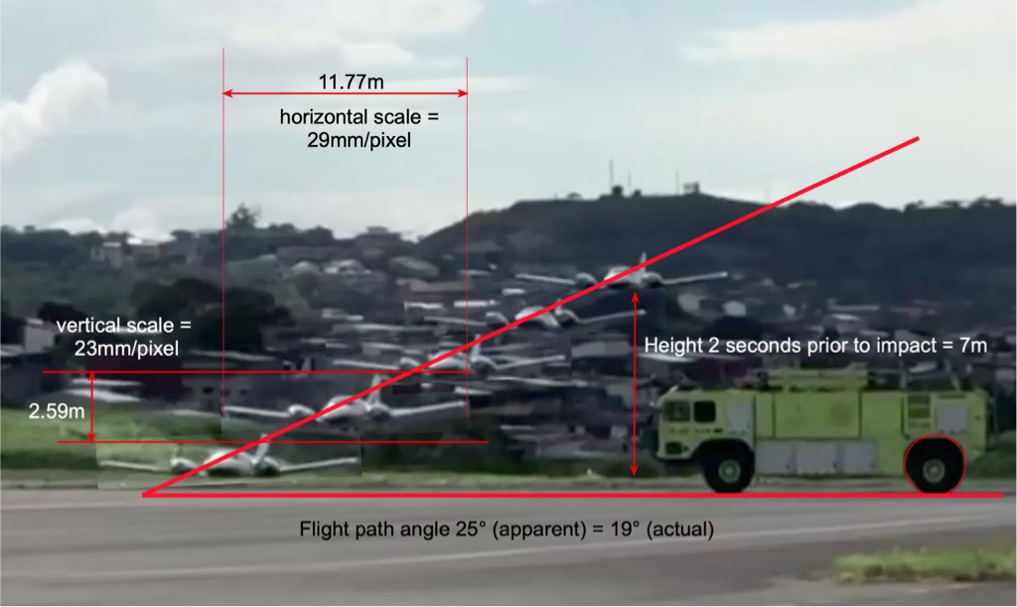

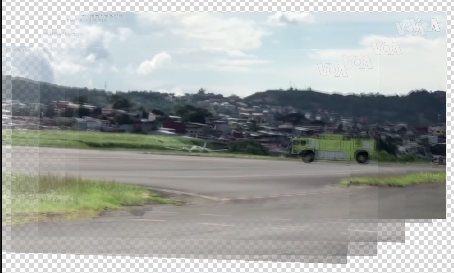

I did some analysis of the video, and it looks like the aircraft was pretty much stalled on final approach.
I extracted five frames at -2 seconds, -1.5 seconds, -1 second, -0.5 seconds and at impact, and rotated and superimposed them to match the horizons:
Then I was able to create a composite of the aircraft position, and make measurements of the apparent flight path angle. To allow for foreshortening I compared the vertical and horizontal sizes of the aircraft, which I believe is a Piper Seneca.
The angle of the video is shot from about 38 degrees off the nose of the aircraft (changing as the aircraft moves, but only a little.)
I estimate the actual flight path angle to be close to 19°, which is pretty darn steep.
Two seconds before impact the aircraft appears to be about 7m from the ground, giving a rate of descent of about 600fpm. If actually descending at 19° to the horizontal the forward velocity would be 20.3m/s and the airspeed 21.5m/s, or only about 42 knots.

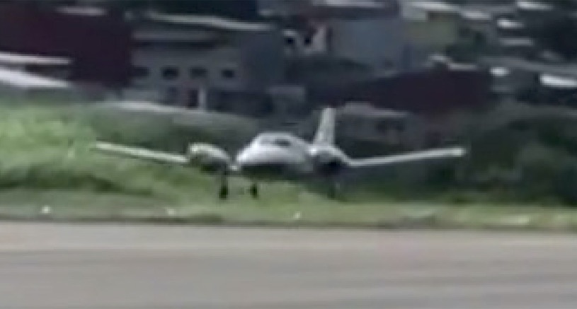

All three gear legs appear to be down:
gear down.jpg (51.91 KiB) Viewed 1489 times

That is excellent Photofly! You've quantified a maneuver which looked bad, as being bad by numbers we recognize.
A concept to remember is that from a stable descent (which this was), it's necessary to add energy to the flight, to arrest the descent (accelerate up from the descending flight path). To have energy to add, you have to have it either as thrust available (not in this case apparently), or a reserve of airspeed, which you may spend to flare. This pilot created a very steep descent path, so much more energy would have been required to flare. And... add to that, that as one pulls to accelerate up from the steep descent path, you might be actually pulling a small amount of G. When you pull G, your stall speed increases, so if you were just about to stall, now you just did, and accelerating up is no longer possible. This video shows that happening.
I opine that it's possible during this event, the pilot probably did pull to flare at the last moment (who of us wouldn't!), and nothing happened, it just kept going down.

I stand corrected wrt the nosegear(all you video wizzes out there) however look at the damage to the props afterward. Now I'm not an acccident investigater, but it looks like there was no power to the prop( blades bent in middle, no rotational damage) does someone who does this for a livving want to chime in
Posts: 6989
Re: No bounce landing
photofly wrote: Sun Dec 15, 2019 8:43 am I did some analysis of the video, and it looks like the aircraft was pretty much stalled on final approach.
Ok. This is super cool. CSI much :mrgreen: :?:
The average vertical speed seems to be 700 fpm. Is that enough to break a landing gear though?
Maybe pilotDAR can chime in here. What is the minimum vertical speed a landing gear needs to be able to withstand upon touchdown for certification?
If memory serves (and it might not) from previous sim sessions, I believe gear damage on transport category jets was not an issue under 700 fpm touchdown. Granted, big planes, but if anything, smaller planes have much less inertia, so they should be more resilient. Makes me wonder if anything else was wrong that the gear literally flew off on this hard touchdown.

I've just been looking at the second camera angle from the video, which shows the approach from a little earlier - about 3.5 seconds before impact, but I'm unable to get much out of it.
We still don't know why the pilot didn't lower the nose to maintain (or increase) airspeed, like the BA pilot did.
GoinVertical
Posts: 148
Joined: Sat Jan 19, 2019 1:12 pm
Post by GoinVertical »
Regarding the definition of stall for airplanes that are controllable well into the stall, I always taught it as the aircraft is "stalled" when the wing has exceeded the critical angle of attack AND is producing less lift than gravity is exerting on the aircraft.
A lot of GA aircraft just mush or wobble down in a descent while being perfectly controllable. Some of them show no buffet or nose drop at all, unless it's an accelerated stall.
I recall a technique an old-timey pilot examiner used to teach to C150 students, if you're in a situation where you lose your engine and can't see good anything to land on (night, IMC) trim full back, keep the wings level with rudder, and you should be able to walk away from the impact. Never tried it or taught it that way, but it probably works similar to the "landing" shown here.
Looks like the aircraft was on the back side of the lift curve, but still controllable the whole way down. I suspect, as others said, even if they did try to flare, it would have had the opposite effect than desired.
