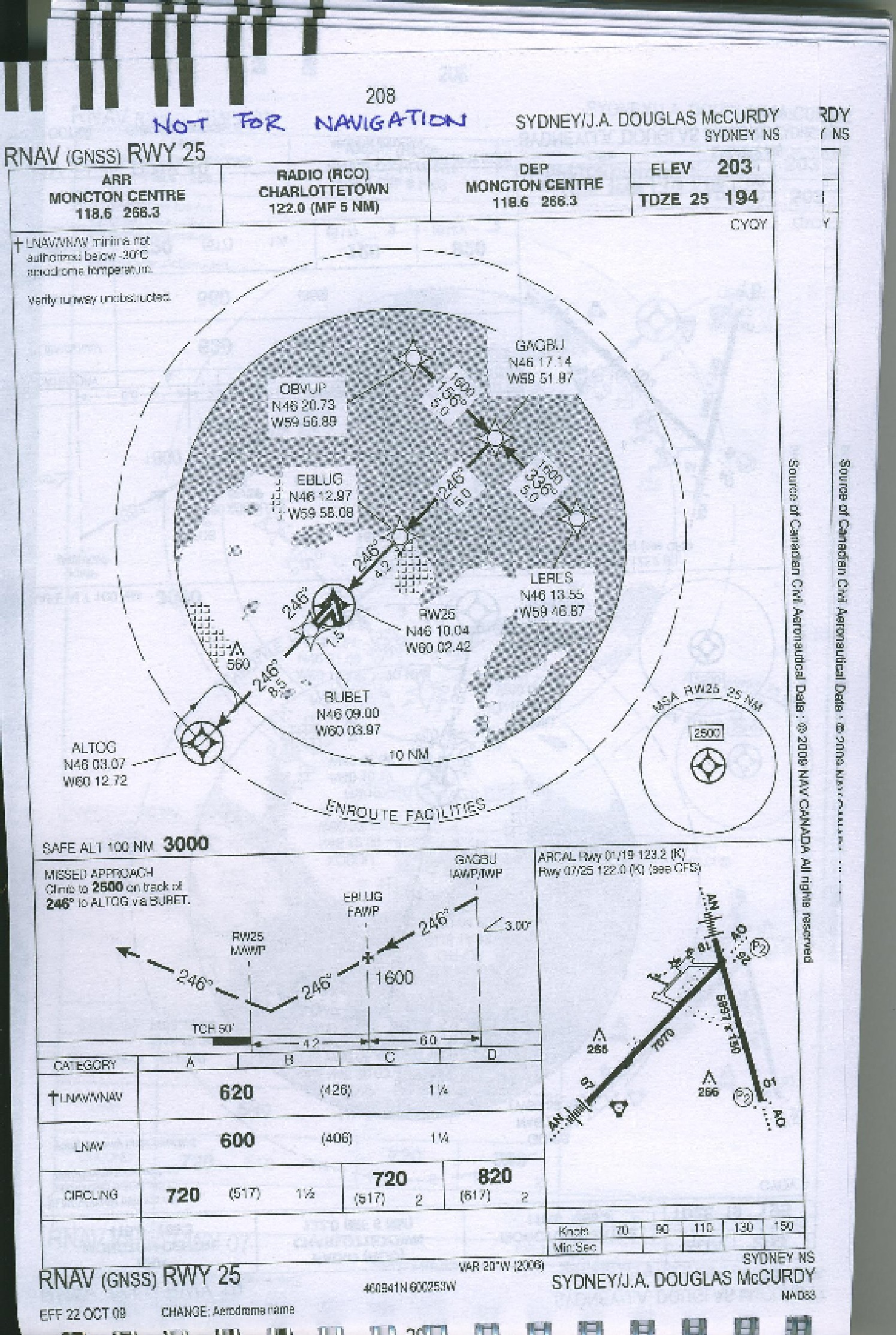

Could somebody please post the plates for the GNSS rwy 25.

The last I saw this plane was just a few hours before the accident. It was on final for 33 at CYKZ that morning.
- Scan10002.JPG (897.3 KiB) Viewed 2201 times

here is a better copy
Sydney Rnav 25.pdf- (232.53 KiB) Downloaded 145 times
