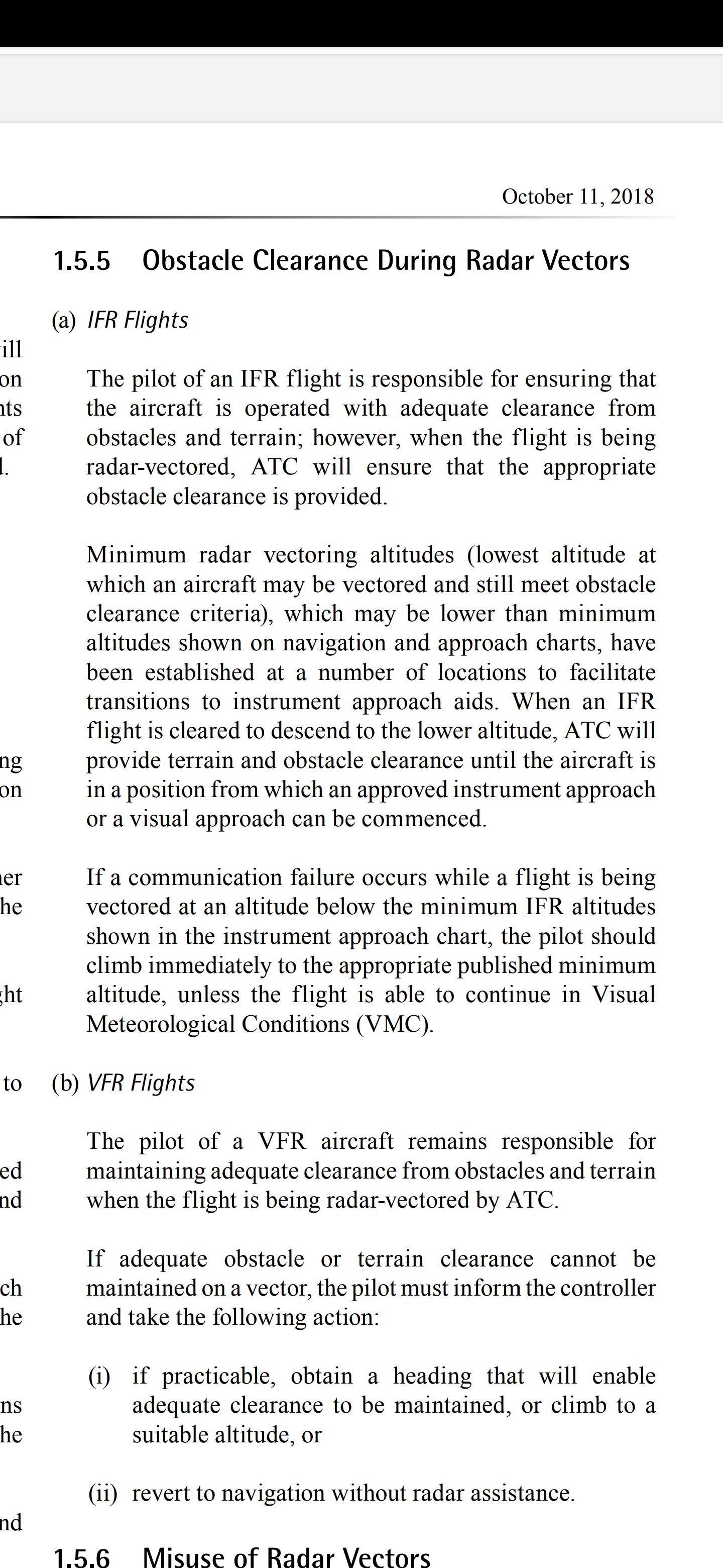

Minimum radar vectoring altitudes (lowest altitude at which an aircraft may be vectored and still meet obstacle clearance criteria), which may be lower than minimum altitudes shown on navigation and approach charts, have been established at a number of locations to facilitate transitions to instrument approach aids. When an IFR flight is cleared to descend to the lower altitude, ATC will provide terrain and obstacle clearance until the aircraft is in a position from which an approved instrument approach or a visual approach can be commenced.

This isn’t what this says. It says if you are on an IFR flight and ATC clears you at an altitude below the published MSA, you should clear obstacles and terrain until an approach can be commenced.tbayav8er wrote: ↑Sat Dec 28, 2019 9:33 pmYes, but if you're cleared to descend to an altitude let's say below the MSA, on a STAR, then following the STAR guarantees terrain clearance. If you deviate from the STAR and get too close to terrain as a result, it's not ATC's fault. They could clear you for the approach as soon as you crossed the first waypoint on the STAR if they chose to do so. By my interpretation anyways.AuxBatOn wrote: ↑Sat Dec 28, 2019 8:39 pmAIM RAC 1.5.5Edelweiss air wrote: ↑Sat Dec 28, 2019 7:13 pm
Not so sure about that, legally speaking the only time atc takes terrain responsibility is when they give you a vector. Unless you can show me a reference otherwise. The only thing I’ve ever seen black and white atc takes terrain responsibility is in the aim when it discusses radar vectors. Otherwise it’s up to you to decide. Now in Canada ATC isn’t going to clear you down to an altitude that’s below the minimum for that sector but direct responsibility for terrain clearance is the PICs in that case.

When you're cleared for an approach, in Canada, your clearance is to descend only to the lowest published IFR altitude, unless you're being radar vectored.

Where do you see when on radar vectors in that sentence?altiplano wrote: ↑Sun Dec 29, 2019 5:38 am When you're cleared for an approach, in Canada, your clearance is to descend only to the lowest published IFR altitude, unless you're being radar vectored.
It says that ATC may assign you altitudes down to the MRVA and they will ensure you miss terrain and obstacles. If they meant when on radar vectors, the sentence would have started with: When an IFR flight on radar vectors is cleared [...]

Uhhh... Yes, it does... take a look where it says it.AuxBatOn wrote: ↑Sat Dec 28, 2019 9:38 pmThis isn’t what this says. It says if you are on an IFR flight and ATC clears you at an altitude below the published MSA, you should clear obstacles and terrain until an approach can be commenced.tbayav8er wrote: ↑Sat Dec 28, 2019 9:33 pmYes, but if you're cleared to descend to an altitude let's say below the MSA, on a STAR, then following the STAR guarantees terrain clearance. If you deviate from the STAR and get too close to terrain as a result, it's not ATC's fault. They could clear you for the approach as soon as you crossed the first waypoint on the STAR if they chose to do so. By my interpretation anyways.AuxBatOn wrote: ↑Sat Dec 28, 2019 8:39 pm
AIM RAC 1.5.5
Your quote is under:
1.5.5 Obstacle Clearance During Radar Vectors ................. 182

The paragraph above and below duly note “radar vectors” in sentences where it applies. It is not mentioned in this one, therefore applicable to all IFR flights assigned a lower altitude.
Example: “You are cleared to YAB, descend to 4,000 feet”. ATC is then responsible for terrain/obstacle clearance.
Subsequently, “You are cleared for the RNAV Y runway 25”. You become responsible for terrain/obstacle clearance.

The entire section (1.5.5) is for aircraft being radar vectored. It only applies to aircraft being radar vectored, even if each sentence doesn't specify radar vectors.
However, in Canada radar controllers are not permitted to clear you to an altitude that has a terrain or traffic conflict. Even on a STAR they aren't allowed to do it which is why "Descend via STAR" was such an obvious disaster from suggestion to implementation to retraction.

“Cleared direct XYZ, descend to 4,000 ft” will guarantee obstacle clearance.
Not all clearances constitute a radar vector and terrain responsibility by ATC.
Can you answer my question?
Do all ATC clearances guarantee terrain seperation?
The “and” in the ATM means it applies when on radar vectors and also when you are cleared direct a fix off airways. You cannot be on vectors and cleared direct a fix at the same time... that sentence would literally mean nothing if you had to be on vectors and direct a fix at the same time since these are mutually exclusive.
Going for the deck at corner
Re: Swoop Terrain Warning
Yes but in your case you are already on radar vectors and now they are putting you in a position to go direct off their vector. It's like the wrap up of their vector, and part of that.
Going in circles here...
Once again, can you answer my simple yes/no question?
Altiplano and AuxBatOn, the reason you two are going around in circles is that you are both correct. In Canada, which is where the incident happened, every altitude or lateral clearance from ATC should keep you clear of terrain. However, this is not true in other places in the world, and Canadian IFR training and the AIM reflect that. Even in Canada, there is nowhere in the AIM that relieves the pilots of the responsibility for terrain clearance except when on radar vectors.
I agree, there is no time, other than radar vectors, that the pilot is relieved from terrain clearance responsibilities.
I provided an example where an ATC clearance did not provide terrain clearance.
ATC will give you a direct, off airway, clearance below sector altitudes. It's not a radar vector and they aren't responsible for terrain clearance.
Everything being quoted above is right under the sections pertaining specifically to radar vectors.
The specifics of this incident are unclear, but it doesn't sound to me like it wasn't a radar vector they were on.
Not in Canada, as per the NavCanada MANOPs and AIC 19/17.
http://www.navcanada.ca/EN/products-and ... 19.pdf#top
1- A controller in a radar environment will not clear you direct a fix if you are below their MRVA. They will ask you if you can climb VFR first at or above MRVA. Happens to me all the time. This absolves them of the responsibility of providing obstacle clearance in that case until you are above a safe altitude.altiplano wrote: ↑Mon Dec 30, 2019 12:02 am You should try flying on an airway at the MEA, but below MSA and ask for a clearance direct to your destination or IAF or whatever... you'll get the clearance...
In fact I've had ATC offer it... on the west coast, at 10,000' with pressurization problems but continuing on the airway at MEA to destination on the North Coast... Van Centre clears me direct to the IAF through sectors with 16,000'+ MSAs while I'm at 10,000'... Who do you think has responsibility for terrain seperation there?
2- If you are above MRVA now but will get to a position where you are below MRVA, they will clear you to climb to an altitude at or above MRVA in your direct clearance.
In any case, their clearance will guarantee obstacle clearance. It is in the ATM that they have to do so.
As far as your question goes, it is to broad to answer with a simple yes or no.
For Swoop’s incident, they were on the STAR, were given an altitude to descend to (which guaranteed obstacle clearance as long as the step downs were respected), were subsequently cleared for the approach (which is the point where the aircraft was in a position to commence am approach) and instead of continuing down the STAR, elected to go direct to the IAF, which is absolutely okay. At that point, however, obstacle clearance is solely the responsibility of the crew and they failed to climb to a safe altitude given they were off the STAR.

I would argue that it is not "absolutely ok" in this case because the approach they were conducting (custom RNP) has specific instructions on how to execute the approach when cleared for it in the notes / set-up description.AuxBatOn wrote: ↑Mon Dec 30, 2019 9:14 am1- A controller in a radar environment will not clear you direct a fix if you are below their MRVA. They will ask you if you can climb VFR first at or above MRVA. Happens to me all the time. This absolves them of the responsibility of providing obstacle clearance in that case until you are above a safe altitude.altiplano wrote: ↑Mon Dec 30, 2019 12:02 am You should try flying on an airway at the MEA, but below MSA and ask for a clearance direct to your destination or IAF or whatever... you'll get the clearance...

You realize this entire conversation has been in regards to RADAR controlled airspace, right?altiplano wrote: ↑Mon Dec 30, 2019 10:09 amI don't read ATC manuals, but I know what my responsibility as a Pilot is.ahramin wrote: ↑Mon Dec 30, 2019 9:05 amNot in Canada, as per the NavCanada MANOPs and AIC 19/17.
The whole country, especially in the mountainous regions, is not radar airspace. Maybe it's changed, but as I said, I've been cleared direct on what was a stupid route and when I challenged the controller (Center) on the routing he said it was with my own terrain.
It really isn't... it's pretty simple and the answer is No. You are responsible for your own terrain unless you are on radar vectors. These guys weren't on radar vectors.AuxBatOn wrote:As far as your question goes, it is to broad to answer with a simple yes or no.
But looks like these guys weren't even operating with a proper clearance.
Deciding on your own to just turn direct somewhere in a terminal environment because you were cleared an approach while on the STAR isn't reasonable either. You acknowledge that the controller wouldn't have cleared them direct because they were below his MRVA, so why did they do that? You acknowledge they weren't on vectors... so if you're going to try to cut the corner on your own, you better have your own terrain.
Ultimately it's a good thing they were in a terminal radar environment... how would that have worked out in the many other airports in those hills without a terminal controller watching them truck on down into the ground.
Obviously if you're cleared the kitimat beacon and 9000' you aren't going to go descend into a mountain....
