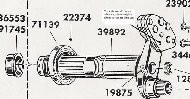

The following information is from the TSB preliminary information given to us prior to their final report.
This is a scanned portion of a page from the 985 parts manual showing the crankshaft and the forward balance assy. The text arrow is pointing to the rivet which attaches the balance weight to the crankshaft arm and it was through this hole that the crack initiated.
When we removed the balance unit from the top of the engine, we saw the circular scoring marks in the bore and thought they may have been from the rivet being loose and rotating but TSB thinks it may have been a manufacturing defect, possibly caused by a dull drill.
Whatever the cause, the question arises about the qualification of the crankshaft at overhaul. I checked with one Canadian overhaul agency and there is no requirement to disassemble the balance weight from the crank arm for the MPI. TSB feels that this crack would not have been detectable during MPI without the unit being disassembled.
TSB is just completing their hardness testing of the components and will have their report issued soon. We will keep you informed.

As I promised to keep you updated, I have talked with TC this morning and they will be having one of their NDT people look at the crankshaft in the coming days to see if an alternate method of inspection can be done at overhaul, which would still allow the inspection to be done without removing the balance weight.
Will let you know the next stage.

We have finally rec'd the report from TSB concerning our 985 engine failure with the Beech 18 last summer.
http://www.keepandshare.com/doc/view.php?id=432333&da=y

Thanks for that, Carholme,
Fascinating read, but the pictures leave me with a lot of respect for the people doing the analysis... Impressive work.

So Carholme, is there going to be a change to the way the crankshaft is inspected at overhaul? Or are these engines so old, (and used only for "small" a/c), such that no one cares?

We just have to wait to see if TC applies any further inspection criteria.
I do know that they are investigating alternative inspection procedures to ensure that the area can be inspected without removing the counterweights. As you will note from a previous, this area cannot be inspected at crankshaft overhaul using existing means.
