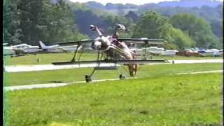

That's quite true during a tailslide or a torque roll.the tail is also forward and the prop aft

Re: Why is water in the fuel tanks bad?
They're a little tricky, but getting better.
The good news is that I can drain the water
out of the tanks after landing by just opening
the caps.
the caps.
