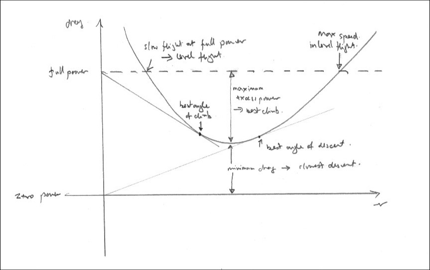

Re: V_x and performance takeoffs - POH discrepancy
Colonel,
I believe you've mixed up your "power on" and "power off" curves (your diagram shows the "power off" curve).
It's more intuitive to make the vertical axis a measure of "Engine Power minus drag", i.e. the excess power which is (ideally) converted 100% to rate of climb. Points below the horizontal axis represent a descent, points above, a climb, and then climb or descent gradient can be measured by the angle through the origin.
What your diagram indicates (correctly) is that the best angle of glide is slightly faster than the glide speed for slowest descent.
But the power-on curve shows that the best rate of climb is slightly faster than the best angle of climb, which is indeed on the back side of the curve.
In real life as you add engine power the drag curve slides sideways (a bit) and changes shape because it depends on aircraft attitude to the airflow etc, so Vy isn't exactly the same as the glide speed for slowest descent. In fact for the 172M best glide (distance) is 74MPH which is the same as Vx. Vy is actually 90MPH - the curve shifts to the right from zero to full power.
Your graphical treatment of a headwind is correct, and your comments rightly refer to gliding. As far as climbing into a headwind goes, you should actually climb slower than Vx, i.e. more on the backside of the curve, to get the best angle.
Alternatively, if you prefer to consider the drag curve rather than the excess-power curve then full-power climbs and glide descents on the same graph would look like this. You can see that for climbs and glides the point through which you draw the tangent is different in each case.
Scan 2.jpg (47.13 KiB) Viewed 2160 times
What you can't show very easily this way is that the power curve moves sideways in real life.

Either you are mixed up or I am. At the bottom of the curve, you get max L:D, best powered range, and best glide (angle, not slowest descent). On your diagram you've got the best glide for min sink at the bottom of your curve -- this should be at a slower speed than max L:D, which gives you the greatest distance covered over the ground (angle).
Trematode wrote:Photofly,
Re: your drag curve diagram.
The axes of the graph correspond to vertical and horizontal speed so your climb or glide angle is the same as the angle of the line through the origin. Best l/d isn't at the bottom of the graph, it's where the tangent line is. The bottom of the graph is min-drag, and gives you slowest rate of descent, best time endurance, and best rate of climb, depending on power.
Post by Trematode »
Photofly -- I am very confused.
The main discrepancy I see in your graphs is that the relationship between the speeds along the horizontal access is not in the proper order
In a propellor driven air craft the relationship between speeds should be as follows (slowest to fastest):
1. Minimum power required/max endurance/minimum sink glide
2. Vx
3. Minimum drag/max range/best glide
4. Vy
Your graphs show Vx as slowest, followed by Vy and Minimum sink together -- the two aren't directly correlated like this -- and then best glide
No, aerodynamics and physics remain the same.
Sure, I get that, I just wondered if the ability to set down on the water made you more confident about cruising low. If you have an issue in a land aircraft at 100ft you don't get a lot of thinking time and you can't float it out. Not saying, just asking.
