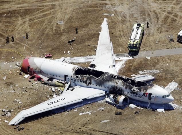

Whoa ... 3 seconds to impact - last recorded airspeed 103 knots, engines at 50 percent power with power increasing.
Joe Blow Schmo
- Posts: 357
- Joined: Tue Jun 10, 2008 2:48 am
Re: A Boeing 777 Has Crash-Landed At San Francisco Internati
Not true. Whether they were flying an ILS Glideslope or an VNAV generated descent profile, it would have taken them to the correct place regardless of altimeter settting. The only thing they might notice is that the waypoint crossing heights don't match what their altimeter says if the altimeter is set wrong. But as somebody above said, it's VERY difficult to forget to transition in a 777. They would've had to both actually set the same wrong altimeter setting at transition as opposed to just forgetting to do it. And it would've had to be the same error for both of them. If the Captain and FO have different altimeter settings set, you get a message.Indanao wrote:There is a rumor the Altimeter may not have been reset from 29.92 at cruise. The field Altimeter Setting was 29.81. An altimeter error of -.1 would put them 100ft low, and 1000ft short. ( If they were flying an electronic generated glide slope, it would take them to the Sea Wall. ) ?? A VFR approach shouldn't have that problem.
From today's NTSB briefing:
Vref: 137kts
1600': A/P disengaged
1400': speed 170 kts
1000': 149 kts
500': 134 kts
200': 118 kts
125': 112kts - initiation of power increase
3 secs before impact - minimum recorded speed of 103 kts
A couple of points based on that: It would seem the autothrottle was also disengaged (unlikely the speed would have decayed so much if the A/T was engaged). I don't know if this is Asiana procedure when the A/P is disengaged or if they were practicing a manual thrust landing as part of the captain's line training. Other airlines I know of usually leave the A/T engaged when hand flying on the 777.
They were 25kts below Vref (and probably 30kts below target approach speed) before any increase in power! WTF? The vicinity of 112 kts is probably where they would get the Airspeed Low EICAS caution message. I wonder if the application of power was in response to that.
At 1400' they were really fast (probably should've abandoned the approach here) which is likely why the thrust was idle all the way down instead of a normal approach setting. Seems like somebody forgot to bring the the thrust back up to a normal setting once the speed decayed to where it should've been.

A/P disengaged at 1600'. My question is what mode was it in when they disengaged it and where were the speedbrakes?
Flaps extended with speedbrakes deployed is most likely a no-no. at least it is on another boeing.

17 mile final with the runway in sight? Unless they were significantly higher than 5000 feet above TDZE, so much for ATC leaving them "high and dry".AvHerald wrote: On Jul 8th 2013 the NTSB reported the pilots' flight bags and charts were located, the proper (approach) charts for San Francisco Airport were in place at the cockpit. There were 4 pilots on board of the aircraft, they are being interviewed on Jul 8th, which will be determine who was pilot flying and who was in command at the time of the approach. The cockpit was documented and the switch positions identified. Both engines were delivering power at time of impact consistent with the flight data recordings, the right hand engine found adjacent to the fuselage showed evidence of high rotation at impact, the left hand engine liberated from the aircraft also showed high rotation at impact. The aircraft joined a 17nm final, the crew reported the runway in sight before being handed off to tower. The autopilot was disconnected at 1600 feet 82 seconds prior to impact, the aircraft descended through 1400 feet at 170 KIAS 73 seconds prior to impact, descended through 1000 feet at 149 KIAS 54 seconds, 500 feet at 134 KIAS 34 seconds, 200 feet at 118 KIAS 16 seconds prior to impact. At 125 feet and 112 KIAS the thrust levers were advanced and the engines began to spool up 8 seconds prior to impact, the aircraft reached a minimum speed of 103 KIAS 3 seconds prior to impact, the engines were accelerating through 50% engine power at that point, and accelerated to 106 knots. The vertical profile needs to be assessed first. There was debris from the sea wall thrown several hundred feet towards the runway, part of the tailcone is in the sea wall, a significant portion of the tail is ahead of the sea wall in the water.
I guess that's what some people call a "stablized approach".the aircraft descended through:
This guy might have spent lots of time watching the aircraft
fly itself, but that's a real newbie mistake - especially for a
HUGE aircraft with that much momentum.
The trend of the airspeed - derivative with respect to
time - is king. Non-zero values are greatly concerning - hence
the emphasis on the value of a stabilized approach, and the
need to overshoot if it is not attained.
I can't imagine anyone receiving a type rating in a jet without
understanding that.

Coupla points. In SFO they could very easily have been above 5,000 feet at 17 miles, the standard arrival takes you overhead at 11,000 feet, and then departing the VOR on a heading. The don't start descending you until after that on the downwind, and will turn you base when they want, ready or not, to weave you in with all the other traffic arriving from other arrivals. I'm usually slowing to a Flap 1 or Flap 5 speed at the VOR (roughly 190-210kts). If you aren't proactive about managing your energy, you're going to be high, no doubt about it.
Also, on the B777 it's acceptable to use speedbrakes with flaps, just not desirable with a landing flap setting (20, 25, or 30 degrees) as you'll get a configuration warning. If the speedbrakes are extended with the thrust levers above idle for more than 15 seconds, you'll get an EICAS warning "Speedbrake Extended".
Lastly, the speed tape has a speed trend vector right next to, so besides the seat of your pants, there is an actual instrument to show you if your speed is decaying.
