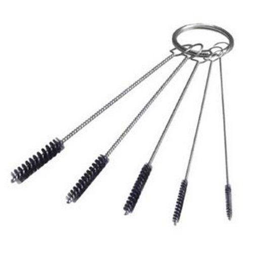

Okay, some ideas starting to flow. These plugs to clean are the size of your wrist with more than 30 wires inside. Replacing the plugs is not an option at this time because it's next to impossible to work in the area. Cleaning the mail end is straight forward but the female end is the challenge. Is there any tool for scrubbing the interior of female socket? Has anyone made something that's not too aggressive to cause damage?
Perhaps a pipe cleaner or small bottle brush?

Pipe cleaner - now there's a thought. Spray with DeOxit contact cleaner and work the pipe cleaner, hmmm. Thinking this is hard to improve on.
Thanks for the suggestion.
