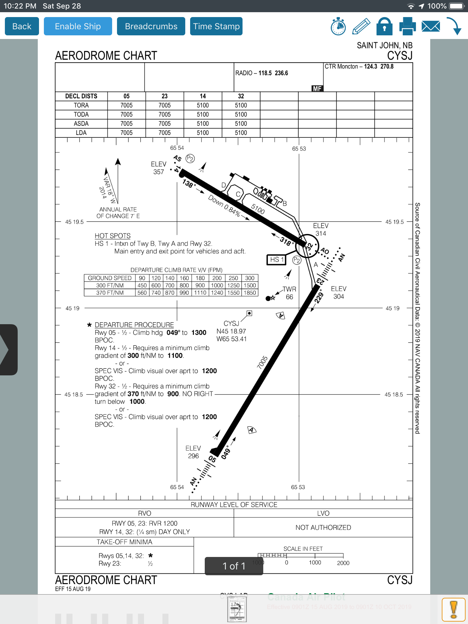

I was planning a IFR flight today with my instructor and we had a different interpretation the definition of “two or More Usable Precision Approaches–each providing straight-in minima to separate suitable runways” in the CAPGEN. For example, CYYT has an an ILS on both runway 11 and 16. To me, if the winds allow either runway, it means I have two separate runways with useable precision approaches and I get 400-1 / 200 - 1/2 minima. I interpret separate runway as meaning it can’t be two precision approaches on opposite ends of the same runway.
To my instructor, it means intersecting runways with pavement touching would not qualify since they are not fully separate. So, either two parallel runways or two runways like in CYMX where 11/29 and 06/24 don’t cross each other(share no pavement).
Which interpretation is correct?

You are correct. Just because two runways intersect makes no difference, they are still separate runways by definition. The only one you cannot count is the opposite end of the same runway.

You are correct. Your instructor needs some instruction...
Are there any airports in Canada east of Montreal with 2 runways that don't touch? Other than maybe something with a parallel grass runway..?

None that I know of. Also, most airport with intersecting runways seem to have one runways served by an ILS and the other one being mostly RNAV. East of Montreal, only St John’s and Halifax seem to have 2 precision approaches that qualify for the alternate minima.

Saint John NBGoinVertical wrote: ↑Sat Sep 28, 2019 1:57 pm You are correct. Your instructor needs some instruction...
CYSJ
