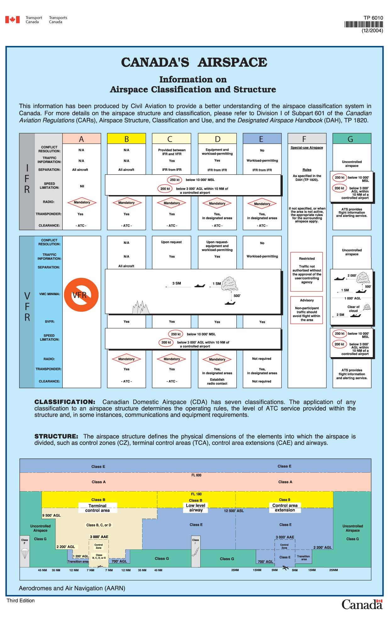

Perhaps this will help....

I'd suggest for those studying these topics to get a hold of a paper AIM, and have a PDF handy to search in a computer. The AIM is so underrated! Much easier to read than the CARS, and very complete IMHO.
For the original question, I'd say the answer is in AIM RAC 4.5 Aircraft Operations - Uncontrolled aerodromes.
The class E mentioned is a CZ for an aerodrome without an operating tower. There's no clearance needed, nor will any be provided.
If the CFS says there's no ground station you'll address "traffic", or "radio" if there's a gs.
In the TP 6010 chart from Transport Canada, the bottom diagram is useful to show that class E airspace can be:
- a control zone (the airport mentioned in the question)
- a low level airway
- a transition area
- a control area extension
So finding answers might get confusing when searching simply by "class E", since one might be mixing up different topics.
In general, airspace definitions can be found in AIM RAC 2.8 Airspace Classification.
"Class E is designated where an operational need exists for controlled airspace but does not meet the requriements for A, B, C or D."
Then it goes on to explain that separation is provided only between IFR aircraft, and there's no requirement for VFR to establish contact. Workload permitting, traffic info may be provided to VFR. This kind of applies to the original question, but then we need to add the modifiers of it being a CZ, and having an MF.
- a transition area
