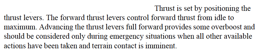

Assuming the failure mode for both engines is the same, what would cause an engine to run hot? Incorrect fuel?
Not familiar with the -200, but is there some sort of "firewall power" available on your good engine for a limited time in the event you need it? I remember on King Airs and stuff I flew without FADEC, if I needed the power to avoid a crash, I wasn't overly concerned with torque or ITT limitations.
telex
Posts: 634
Re: 737 in the water off Hawaii
Post by telex »
JT8D allows "Maximum Takeoff EGT (5 minutes)" and "Maximum Continuous EGT".
EGT varies between the engine versions.
Screen Shot 2021-07-02 at 16.38.16.png (42.95 KiB) Viewed 6245 times
Screen Shot 2021-07-02 at 16.32.06.png (99.89 KiB) Viewed 6245 times

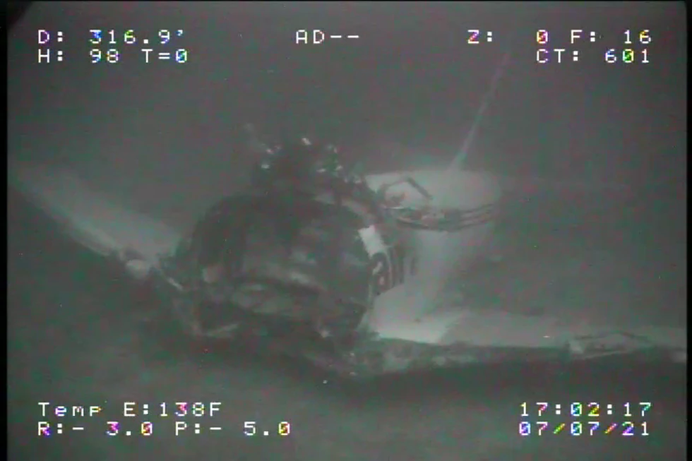

geodoc
Posts: 293
Post by geodoc »
boeingboy
Posts: 1647
Location: West coast
Post by boeingboy »
Wow - Looks pretty intact. Basically it's in 2 pieces snapped right at the leading edge of the wing. The cockpit section looks remarkably good with only the very lower part of the lower fuse damaged, it also looks like the co-pilots #2 window was open .I'm guessing that's how both crew got out (through their respective #2 windows). Very well done for a night ditching.
cncpc
Posts: 1740
Post by cncpc »
boeingboy wrote: Sat Jul 10, 2021 11:56 am Wow - Looks pretty intact. Basically it's in 2 pieces snapped right at the leading edge of the wing. The cockpit section looks remarkably good with only the very lower part of the lower fuse damaged, it also looks like the co-pilots #2 window was open .I'm guessing that's how both crew got out (through their respective #2 windows). Very well done for a night ditching.
+1 on the very well done.
