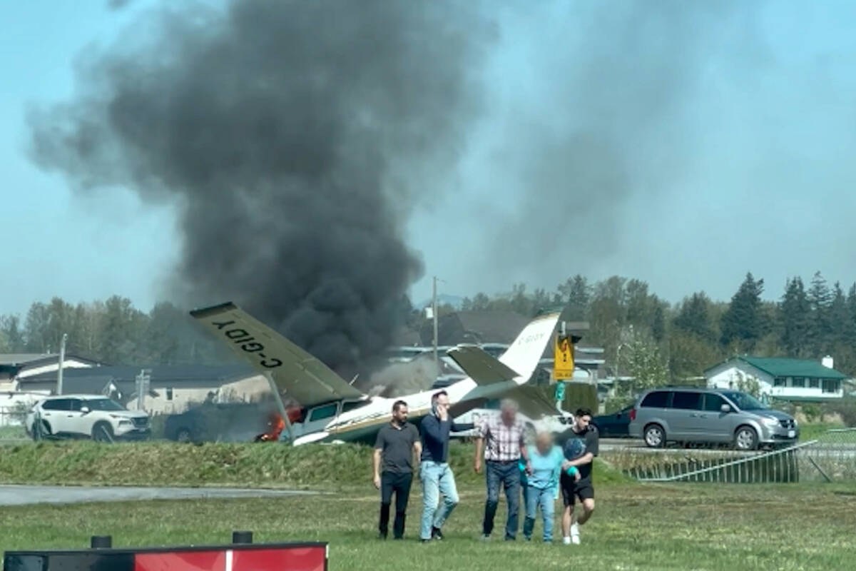

I was there - saw the fire start. He had a fairly new engine in it. His hanger neighbors said he was constantly messing with it. The water cooler conjecture is he lost the engine on short final and in the process of trying to make the runway he clipped the truck - went through the airport fence and ended up against the berm at the end of 25. His wife seems ok and he was burnt. We don't know how bad yet but he was flown to VGH. He probably got burnt crawling over to the right side door to get out.

Not much left...completely burnt out

If you look at the photos, two people were extricated and led away from the aircraft prior to the fire taking hold. Kudos to the bystanders at Langley for jumping into action and getting both occupants out of the aircraft.

Low approach. Know another guy that did similar and hit a fence...........
C-GIDY, a privately registered Cessna 182P, was conducting a visual flight rules sightseeing flight
from, returning to, Langley (CYNJ), BC, with the pilot and one passenger on board. When the
aircraft returned to CYNJ, a straight in approach to Runway 25 was conducted. The aircraft was
observed to be low on the approach. The aircraft struck a vehicle on the public road approximately
450 feet east of the runway’s displaced threshold. It then impacted the airport perimeter fence
approximately 60 feet west of the initial impact and slid a further 30 feet, before it came to rest
against a berm. A post-impact fire started shortly after. The passenger and pilot were extracted
from the aircraft with the assistance of bystanders. The driver of the impacted vehicle was
transferred to hospital via ground ambulance with minor injuries. The pilot sustained serious
injuries and the passenger sustained minor injuries; both were airlifted to hospital. Firefighters
extinguished the aircraft fire and the associated grass fire; the aircraft was destroyed.
