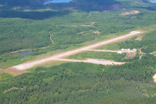

C-GCPX, a Swearingen SA226-AT operated by 2080061 Ontario Inc. (dba SkyCare Air
Ambulance), was conducting flight PHX-011 from Sioux Lookout Airport (CYXL), ON, to Atikokan
Muni Aerodrome (CYIB), ON. The aircraft flew the approach to Runway 04 and touchdown
occurred on the wet runway at approximately 1300 feet beyond the threshold; therefore, there was
approximately 2195 feet remaining. The flight crew applied reverse, and at 70 knots, the propeller
speed levers were selected to the low position. The captain applied the brakes to slow the aircraft;
however, the aircraft overran the end of the runway by approximately 15 feet. The flight crew
assessed the situation and attempted to turn the aircraft around on the grassy area beyond the end
of the runway; however, the aircraft became stuck. The flight crew shutdown and the 5 occupants
disembarked from the aircraft. There was no damage to the aircraft. There were no injuries.
A post-occurrence review of the weather indicated that the automated weather observations at
CYIB recorded surface winds at 21:00z were 330 @ 17 knots. The operator's maintenance was
dispatched to CYIB to free the aircraft. They inspected the aircraft and returned it to service.

One of the worst airports/runways in Ontario. I’d take a gravel strip in the north over yib all day. It’s surrounded by tall trees and has a very annoying down slope when landing on 22. Worst runway lights in the country, and closest weather info that is accessible in flight is from 50 nautical miles away. I’m not a fan.

The dreaded Atikokan for context. Feared by MNR and medevac pilots alike.

They used the runway with the upslope and still overran it, so I don't think that's a factor in this case.The aircraft flew the approach to Runway 04

I wasn’t really commenting on the skycare over run, more so just YIB in general. Although over run with that up slope as well is interesting. 04 is a more comfortable runway to land on than 22.
Feared is very dramatic Jean Pierre. The airport/runway does suck though, that’s a fact. I’d prefer a Pik trip at night over YIB. Those MNR airports up north are generally always well maintained, well the runways at least. Terminal buildings could use some help haha. Can’t say the same for the municipal airports though.
