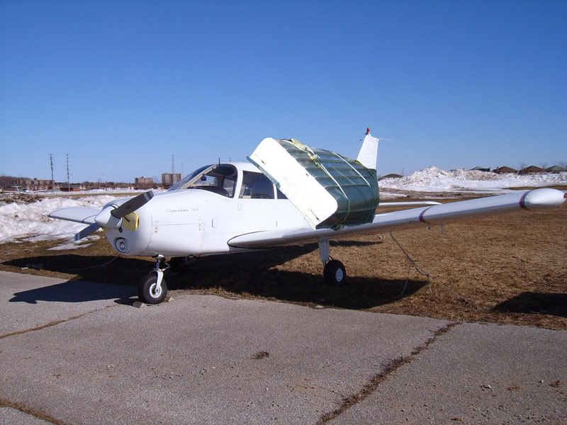

It can be a bit of a challenge sometimes but fortunatly I am a hell of a pilot. :wink:
P.S. Dont ask my why the hell someone would be flying a boat in the winter.

Sweet pic, niss!
-istp :lol:

This will probably start an argument, but that boat should be on the right side of the Beaver, not the left...

Now tying a load on a Beech 18...... :D thats just cool looking! I bet niss could almost do it with his cherokee! may have to extend the struts or get bigger tires though!!
Don't give him any ideas, 185_guy! :shock:

Am I the only one that noticed a bit of trick photography with the Cherokee
No. But it's still cool!
-istp :supz:
