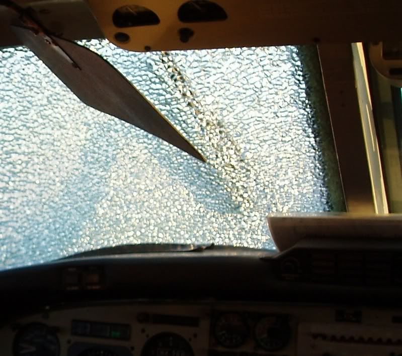

Windshields crack all the time. Since it is not a safety of flight concern, progress towards a fix is slow coming. I do not have a link but a windshield cracked in a B200 inflight between Arkansas and Virginia last week and the flight crew screwed up big time. Dumped pressurization @ 27,000 ft and then tried to get oxygen. Lost conciousness and dived to 7000 ft, loosing one elevator and stab and 2/3 of the other elevator and wrinkled the wings. I saw a video and it looked like the wings were just shy of failure. If the windshield in a Beech cracks, it does not loose all structural integrety and will not blow in, especially if one follows the emergency checklist which says reduce pressure differential to between 2 and 4.6 within 10 minutes. Just slow down, go down and decide who will land the airplane because visibility out of the cracked windshield is zero. I was sitting in the right seat of a 350 when the left windshield cracked so we returned to Vancouver and I landed the airplane from the right seat. No sweat and no one was killed or injured. I will bet that the Denver problems can be or will be traced to sand or other hard substance blown by the wind and develops stress cracks.

I've lost 3 or 4 on the F-27. Depending on whether it's the inner or outer pane, the response is a bit different, but generally it was to shut off the heat, reduce to 1 psi differential pressure and slow to the appropriate speed. The one that scared the shit outta me was the right hand sliding window. I had an inner pane go on me once with a helluva bang. The glass splintered and flew all over the place. I was eating lunch and had to throw it out cause it was full of glass.
