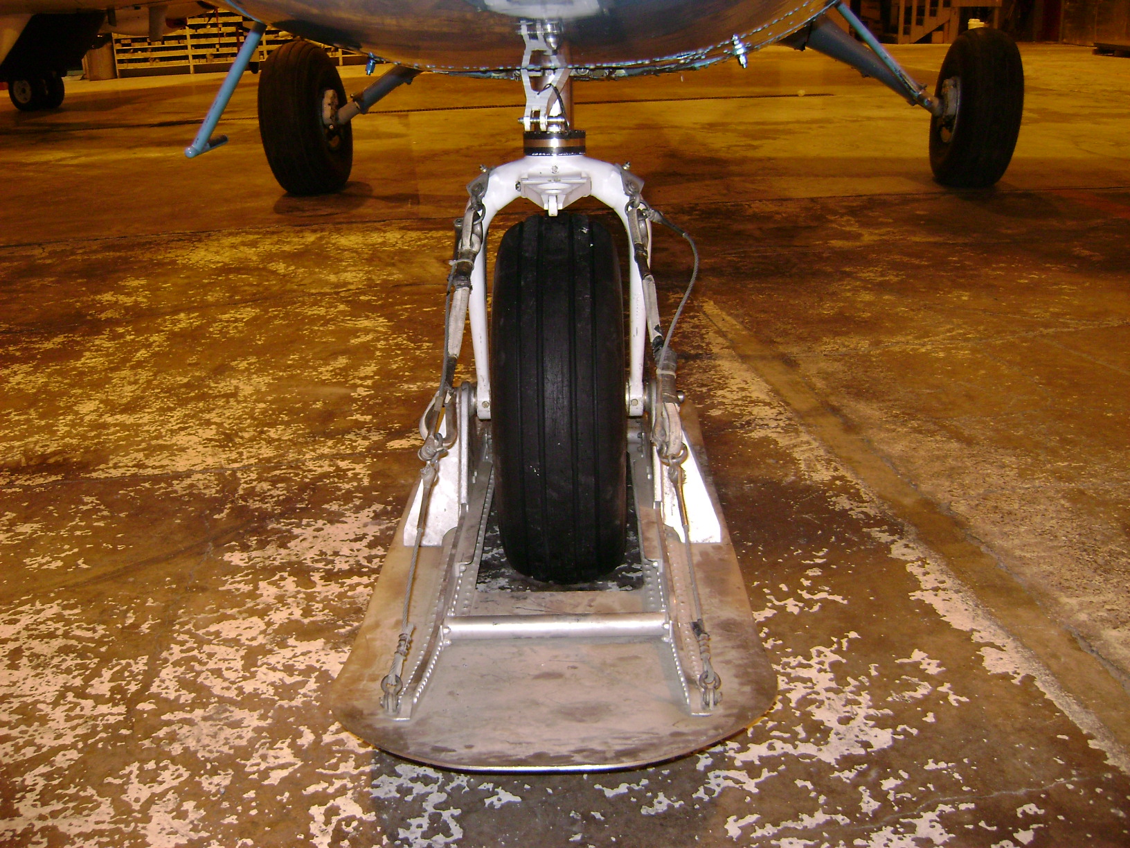

here ya go.
DHC Soft ski 004.jpg (793.52 KiB) Viewed 3659 times
DHC Soft ski 003.jpg (816.62 KiB) Viewed 3664 times

that looks like a really simple rig, I guess there isn't much need for travel re: the short bungees.
One thing I dont understand is why the torque link is undone?

Just a guess .. but since it's in a hangar, probably for extra mobility in maneuvering it around

The reson for the torque knees being disconnected is for towing the aircraft. If you do not disconnect them you will damage the Nose Wheel steering.

I do have some DHC-6 ski pix and hopefully I''l post them someday but in the meantime" jezus who asked why is the torque link undone"
Are you in kindergarden?????
As per the last post if you don't undo it you'll be kicking frozen horse turds down the road real quick

Flaps is correct in his summary. The fixed ski allows for operation into places with say a foot of loose snow on a runway, whcih is generally not enough to justify skis. They are substantially lighter than boards or wheel skis
Their main benefit in the barrens is that the hard drifts (sastrugi) will slow rotaion and pound the nose gear, which is attached to the dreaded station 60.
It's funny how much you can get out of picture. That's my regular machine in the hangar, which rarely gets put in there.
Few people now operate with them.

Are those old pictures or did they get rid of the inter-locking brick floor in the hangar?

First time they'v been on in 20 years, so... no more brick floor.
