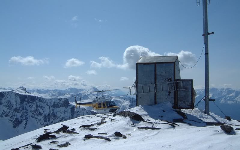

Great story Boosted,
(I must apologize for the typing in the previous post - insulin shock...)
It's one I've experienced a few times, and most of us flying here in B.C. can relate with.
There are many occasions when a "quick trip" to a repeater turns into a very serious situation. I actually got quite annoyed with my customers last November when they showed up for one of these quick fixes in jeans, with no proper gear of any kind, and of course too much weight for the 7000ft repeater site.
We arrived in the area, the ceiling was about 8000ft, with a lot more sinister weather baring down from the North West. I had another crew in the area, so after the initial drop off at the repeater amid worsening conditions, I left to go the 4nm where my other crew was located. Descending out of about 5000ft over the lake, it started to snow, and realizing things were moving MUCH faster than they looked, I decided to head back up to collect my repeater guys.
Except.... They hadn't turned their radio on, and both were in the clamshell when I landed on the peak... There had been much fresh snow and the landing was a classic white out with very little reference and rather off-level, rendering me unable to leave the machine to get the guys. Now, as a pilot, you are responsible for your customers, like it or not - even ones who don't show up with proper gear, don't turn their radios on after drop off despite a thorough briefing to the contrary, and inexplicably, don't bother to look out the door when the helicopter returns not 5 minutes after drop off in worsening weather!
"Pissed" doesn't do my feeling justice, so I sat idling in the snow, increasing wind, and now gathering clouds waiting for one of these guys to get the message. They finally did, and once we loaded up, things were dramatically different than they had been not 5 minute prior. Now, faced with a very tricky departure down to lower altitudes, I wasn't exactly a happy camper. Of course it worked out, but that same scenario Boosted outlined has played itself out so many times in the past.
Operating in the mountains, particularly in helicopters, put pilots in many situations where they are responsible for not only their own lives, but those of the customers. Not respecting the environment will kill you, as Boosted said, regardless of hours.

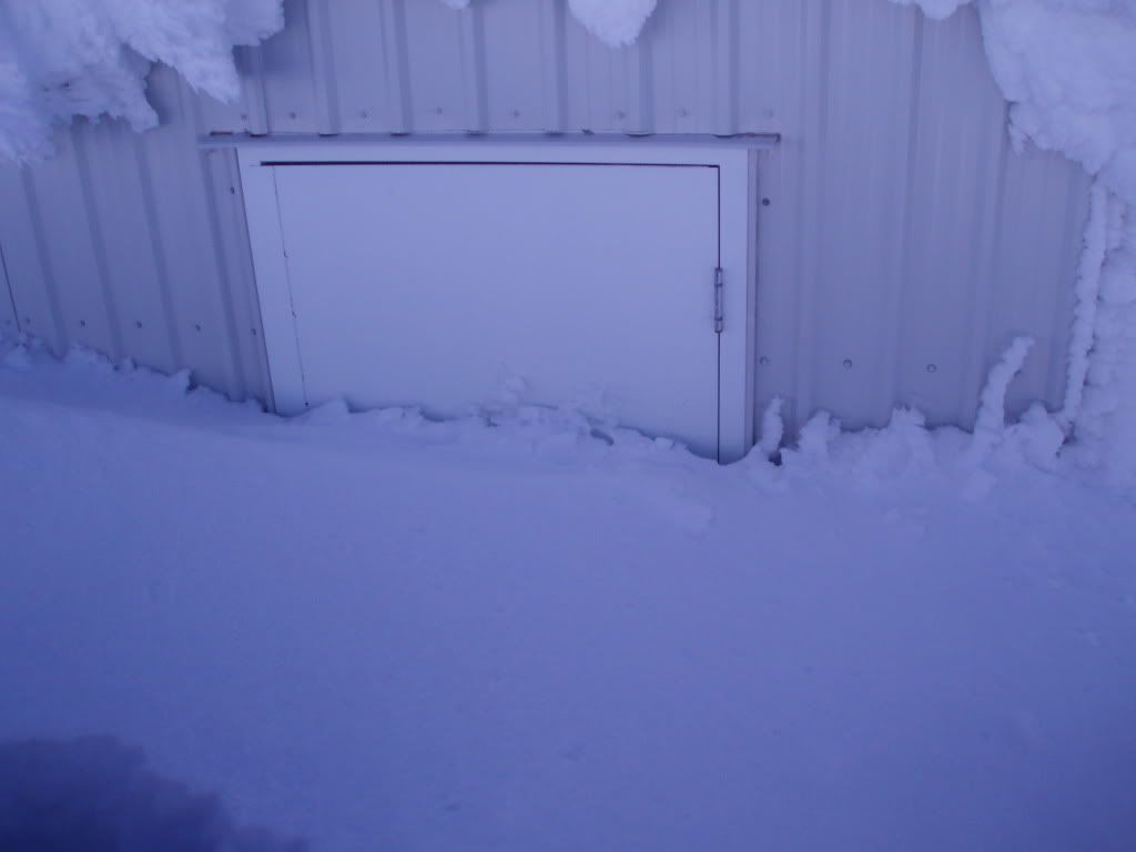

BoostedNihilist
Re: Coastal / Mountainous Experience
Post by BoostedNihilist »
STL
Yeah, I always take a pretty good crash kit with me when I get dropped.. never know.
Anyways, I'll see your cold-ass mountain top photo
and raise you an 'oh @#$!, who brought the shovel?'
Posts: 4614
Post by sky's the limit »
Lol,

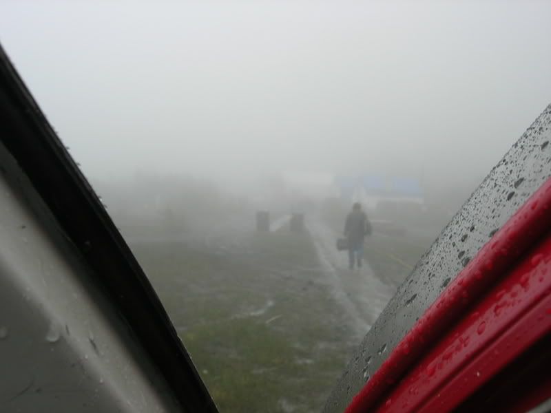

Finally! Somebody's decided to play the photo game with me... Very exciting....
You're one of the smart customers then, you are few and far between. I've taken to regularly sending them back to the office or home for extra gear before going somewhere....
Nice picture, looks alot like the DEW Line sites up in the Arctic.... But speaking of mountain weather, here's one of a Geo Student who got himself stuck at 6000ft up a mountain on the Alaska border just out of Stewart, BC.... It doesn't really need explaining other than he had not packed the mandated gear in his pack, and this came in.....
Impressed I was not... He got a lecture to end lectures!
Stl, we get that ALL the time.. people showing up for charters wearing jeans/khakis and a tee shirt in the damn arctic!
Weather changes in these places quite quickly.
