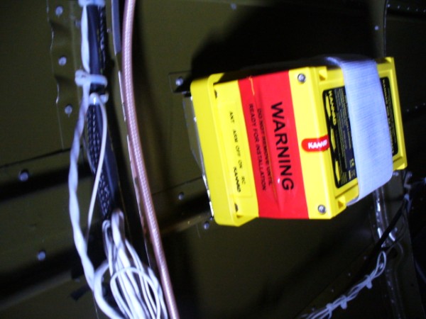

What about bending up a hat section and bridging it between the two stringers you find on most Cessnas. I know the 100G loading sounds like alot at first but remember 100 x1.85 lbs ( weight of ELT approx) is only 185lbs of force. Using 2024-T3 0.040-0.050 with some MS20470-4 rivets would be sufficient. Ill take a pic of a couple of installations showing what I mean and post later.

Here is a couple pics I said I would post. I screwed up when I said stringer. I meant former/rib/whatever you wanna call it. If you notice the ELT is mounted to a hat section that is riveted to the skin, as well the ELT is secured to the mount with a strap. The strap is from the ELT manufacturer so it must be rated to 100g's. The second pic is just an idea of something you can bend up and install.

Feel free to correct me if I'm wrong but, I believe that we are not allowed to attach the bracket to the skin. It has to be attached to structure.
twotter
Posts: 1483
Re: 406 ELT
Post by twotter »
cntrctr wrote:Feel free to correct me if I'm wrong but, I believe that we are not allowed to attach the bracket to the skin. It has to be attached to structure.
You are quite correct, the first picture won't cut it.. I ended up having to build a rack in the baggage compartment that tied into the floor structure. There just wasn't anywhere to attach behind the bulkhead..

Who signed out that installation in the first picture?
You'll be real happy if you crash and instead of your ELT going off it goes flying past your head with it's tray and everything else.
