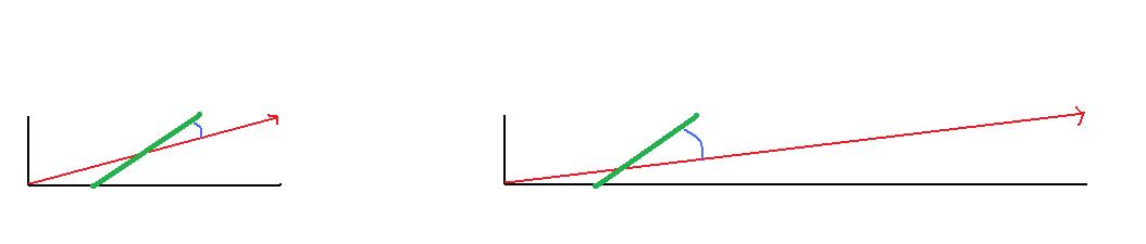

since im starting vacation today:
i only did it for a climb, you should be able to figure the descent out from this
the verticle axis represents the verticle speed - constant for both wings
the horizontal vector is the forward velocity of each wing - outer wing moving faster
the red vector is the net velocity of the wing - airflow being opposite to this
the gree line is the attitude of the wing - also constant for both wings
the angle between the wing and net velocity is th A of A
this isn't to any sort of scale, just made to be visible

to figure it out for the descent just draw the verticle speed vector pointing down and re-draw the net velocity. keep the wings at the same angle just to make it easy to see the difference.

Thanks Tim, that's a niffty little picture.
Re: WANTED: VISUAL GRAPHIC of angles of attack during turns
Awesome, that does make sense. But, in a descent, the outer wing is still moving faster, it seems like drawing another diagram like yours would show the outer wing still having a greater AoA...? (even though we know it doesn't)
Or most likely I'm missing something
EDIT: nm, I think I got it... just flip those diagrams upside down and it works!

how would you define/explain the net velocityTIM : the red vector is the net velocity of the wing - airflow being opposite to this
I'm glad you wrotte that, i've never been able to find a proper explaination to that,

not sure where you would ref it, but its just the way the plane is moving. your climbing and moving forward at the same time. think of walking up a hill. your net velocity is the diagonal line up the hill.scopiton wrote:how would you define/explain the net velocityTIM : the red vector is the net velocity of the wing - airflow being opposite to this

the green line repsents the wing, and it is not a variable. both wings have the same angle. one is higher relative to the other, but the angle relative to the horizon is the same for both wings.Bronco Billy wrote:Hey Tim,

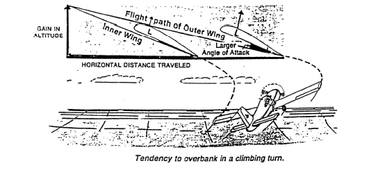

Hope this one helps, I find it works great.
- descending turn.jpg (102.19 KiB) Viewed 3704 times
- climbing turn.jpg (101.53 KiB) Viewed 3704 times
thats the exact diagram i had in mind when i drew out that little paint thingy. what text book is it in?
I can't remember where I found it originally, but I made a photocopy of it for future use. I wouldn't mind knowing where it came from.

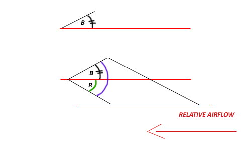

The Climbing Left Turn.
I draw a red line on the white board representing the relative airflow and take out my E6B metal plate and incline it as a normal climb.
This is shown by angle Bravo in the first schematic.
Then by rolling and maintaining a banked attitude to the left, you have inclined the wing by a component of angle Romeo.
Bravo + Romeo = Net Angle of Attack on up going wing
See picture one
Using the same example for the down going wing wing, you have angle bravo during a normal climb, and then with a wing drop, you have a a declining angle "angle Yankee"
Bravo - Yankee = Net Angle of Attack on the down going wing.
Sorry about the pictures my 3d drawing isn't up to par with Photoshop. And Tramp, you're 150% right about needing two axies in that case. But since we only have one axies, the angles have to vary due to their rotation about it.
This was the way that was taught to me; please correct me if I'm wrong.
But if the student is really bright it's really simple. The plane climbs at 700 fpm, the wings are attached to the plane so they are also climbing at 700fpm. As a result our VS is a constant. Since the outer wing is going through more air in order to get to altitude, it has a shallower net velocity. And since the inner wing is going through less air, it has a steeper velocity. Draw a wing and you get the different angles. Just like what Tim said.

Thank. To me, this is the best way to explain it. Might work pretty well with students that are not too visual.loopa wrote: But if the student is really bright it's really simple. The plane climbs at 700 fpm, the wings are attached to the plane so they are also climbing at 700fpm. As a result our VS is a constant. Since the outer wing is going through more air in order to get to altitude, it has a shallower net velocity. And since the inner wing is going through less air, it has a steeper velocity.
