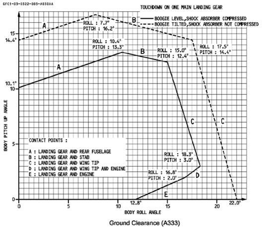

It's one of the recommended techniques and isn't risky at all provided you remain within the limits of the airplane. This chart is from the 330, but the 340 isn't dramatically different. You can see that at a typical touchdown attitude of 5-7 degrees, the wingtip contacts the ground at around 20 degrees of roll with the bogie tilted and the oleo extended. That reduces to around 17 degrees with the bogie level and oleos compressed. The engine doesn't hit until the pitch reduces to around 3 degrees and at a bank angle of 18 degrees.MichaelP wrote:I would imagine the sideslip method in an Airbus 340 is extremely risky.
- Bank limits.jpg (59.62 KiB) Viewed 2840 times

I read the stuff above about the A330 and it's all well and good but those wings flex with the downloads on landing and so you need to consider the vertical decelleration and it's effect on depressing those pods!

It's not a problem. 10 degrees of bank when sideslipping for a crosswind landing is a lot, but it's still well below strike territory. Some manufacturers recommend using the crab and kick straight at the last second method above a certain crosswind component though. I don't like it personally because it can destabilize what was a good approach up to that point. In a really long airplane you can move the cockpit sideways around 20 feet suddenly using that method which can be a bit uncomfortable, and it has some inertia behind it unlike a cessna so I prefer doing things more slowly and a little farther back.MichaelP wrote:I read the stuff above about the A330 and it's all well and good but those wings flex with the downloads on landing and so you need to consider the vertical decelleration and it's effect on depressing those pods!
The A340 has two spare hair dryers out there right?
