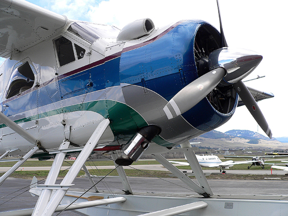

Have you ever seen this mod, with the muff over the short stack?
I wonder how effective it is?
Looks like it probably saves some weight and the stack-extension keeps some of the shieght off the belly.

HS-748 2A wrote:Have you ever seen this mod, with the muff over the short stack?
To the best of my memory it works as good, perhaps a little better than the convential system. The big advantage was the maintenance side the machine with the can system had less exhaust issues, requiring attention between inspections.

Maintenance wise, of course AD CF-90-03R2 would still apply but yes, I'm sure you're right about fewer problems and the actual inspection of the exhaust stack would be much easier than the 'intensifier-tube' system on the old one.
The long, dirty, sooty, black old tail pipe with that goofy funnel looks better, but that's just MHO. I'm a traditionalist.

Yes we've seen the "new" system. And yes its only a tad better than the intensifier system.... We want to extrapalate on that system by putting a 17" wrapper style shroud on the original "long" tail pipe with heat transfer fins welded on the tail pipe. Remove the intensifier. Weight savings is probally a wash.
The problem with the intensifier is mostly no volume (flow) of air, not heat. So if we design a longer shroud to cover the tail pipe AND increase the heat shroud air intake. You should be able to rest your coffee on the heater duct to keep it hot.
But we would like to omit the perferated holes on the bottom of the tail pipe
