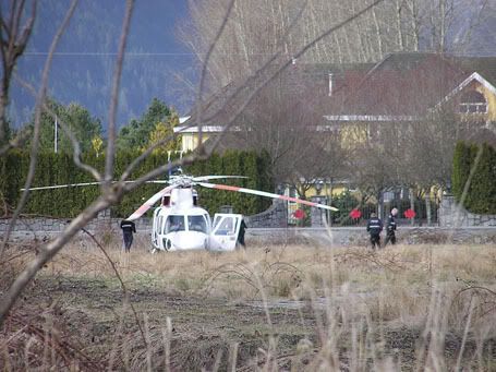

C-GHJT Helijet Sikorsky S76-A Maple Ridge BC March 17/2011
CADORS 2011P0343
Pitt Meadows RCMP report a Medivac flight operated by Helijet International Sikorsky S76A (C-GHJT) was departing from a Farm on McNeil Road at 16:10 PDT with four people on board for Vancouver General Hospital when it stuck a wire. The helicopter landed safely in a field, no injuries reported. Damage to the helicopter is reported as the tip caps on the main rotor.
From BCLocalNews.com
An Air Ambulance clipped telephone wires while trying to fly out a man who injured his back Wednesday afternoon while pruning trees in Pitt Meadows.
The man was standing in the bucket of a tractor on a property off McNeil Road when he lost his balance and fell 4.5 metres into a ditch.
“He was half in the water and half out,” said Pitt Meadows assistant fire chief Brad Perrie.
Firefighters lifted the man out of the ditch and transported him to a helicopter, which had landed on McNeil Rd. As the helicopter took off, its rear rotor hit an overhead phone line.
Dan Froom, executive director of the B.C. Ambulance Service, said the pilot felt vibrations after hitting the wires and landed the helicopter in a nearby field .
Firefighters transferred the injured man into a waiting ambulance, which transported him to hospital via road.
The helicopter remained in the field overnight.
“The helicopter needed to be checked out to make sure it was safe,” Froom explained.

People make mistakes and I'm sure the pilot won't ever do that again. After having a good look, the landing are is doable and it was a judgement error that caused the wire/bladestrike.
The news story is downplaying the damage quite a bit and it's MAIN rotor struck first, with possible debris in the tail rotor too. It's way more than just tip cap damage and I'm pretty sure both main and tail rotors will have to be removed, along with a complete sudden stoppage inspection of the drive train and engines. I'm not a 76 guy but on some helicopters, other components like driveshafts and bearings would have to be scrapped, Even if there is no "visible" damage. Not a big deal though, the engineers will have er back in the air in no time, your tax dollars hard at work.
I've never been a fan of the 76 as medevac machine, it's too big and with the wheels, landing areas are limited, same goes for the 139's. The advantage those corportate machines have is speed, a private company would have a hard time making money with them otherwise but why save taxpayers money when you can throw it around like confetti. Medevac operators provide a great lifesaving service and should be gov. funded but the spending can get out of control. Did ornge really need to buy 139's? does anyone know how much that transition cost?

#1 rule in confined areas: reduce manouvering to an absolute minum. #2 rule in confined areas: if you have to maneuver NEVER pedal turn around the mast, and definitely never put the ONLY know obstacle behind you. Very poor airmanship on display there, and as somebody said above, that will make a great training video.

#1 reduce manoeuvring
the less you move around, the less likely you are to hit anything. Ideally you approach directly to the spot you can land and T/O from. Sometimes....as is the case here by the looks of it Approach/TO was a slightly different area, then hovering to landing spot is required.
#2 Never pedal turn around mast
if you watch the video, the helicopter turns around an axis going through the rotor mast. nose goes left, tail goes right, mast stays put.
problem here is you're swinging your tail, which is 45 feet behind you, to somewhere that you can't see now. he/she couldn't see they were under the wires.
If you were to turn around an axis based at the tail (turn around the tail) then you know that your tail is in the spot you started (a safe area) and you can look to where you are going to place the body/rotor of the helicopter.
not a great image....but you'd leave the tail where it is and move the nose around in a big circle.
This is a useful manoeuvre from an operational standpoint (Fig 16-2) and you will find that it is often used when required to re-position the helicopter within a confined area. The techniques are similar to those, which you employed in sideways hovering (See figure 16-1).
To commence this manoeuvre, look first in the direction that you intend to turn, ensuring that the area is clear of obstacles that could pose a hazard to the helicopter. While doing this, try to imagine that the cockpit of your helicopter is sitting astride the circumference of a circle with the tail of the helicopter at the centre of that circle. Unlike a turn around the mast, where in still wind the turn can be completed with pedal alone, you must now co-ordinate both the pedals and the cyclic to move the helicopter around the imaginary circle. Use the pedals to keep the tail over the centre while maintaining a slow walking pace laterally with the cyclic. Collective is used to maintain the normal hover
