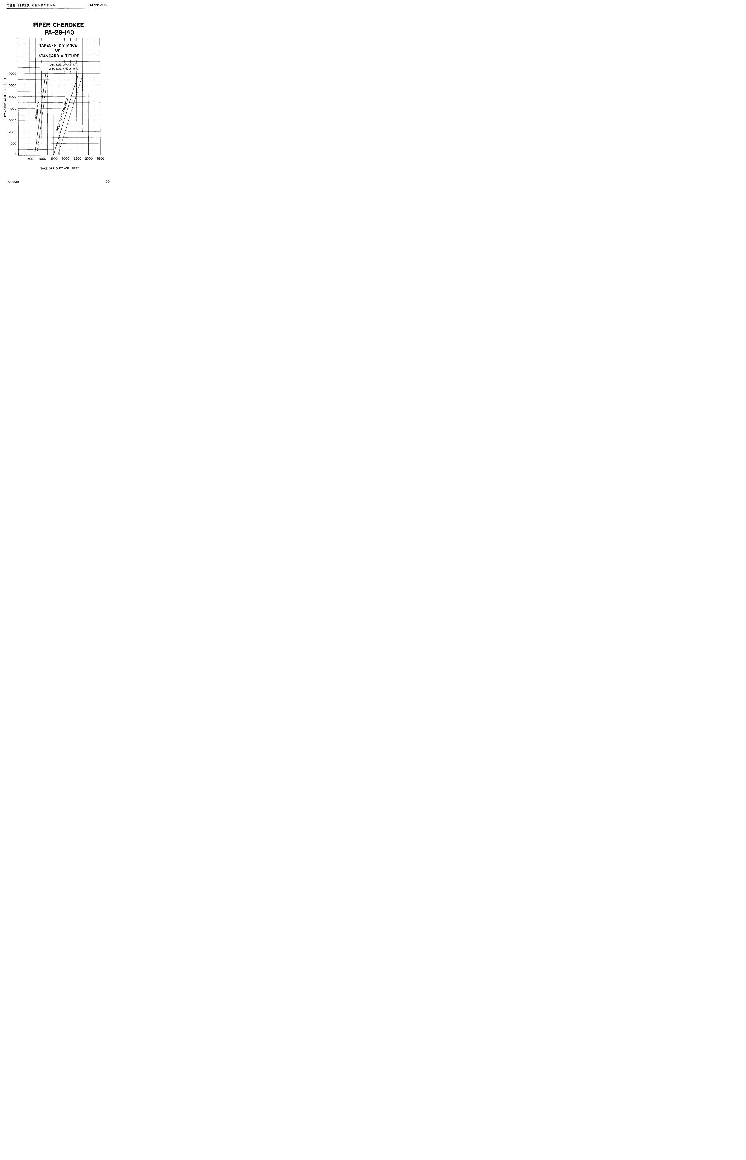

My POH doesn't specify different surfaces but my airport is (crapilly) paved 2100' at ~1000' ASL and she does it no problem with 2 people and at tabs (36 gal). Crushed gravel I would think you would be fine and depending on the circumstances 1800 grass might be ok, but that makes me a little nervous especially with any obstacle.
Charts are for my '66 140 Max Gross 2150
