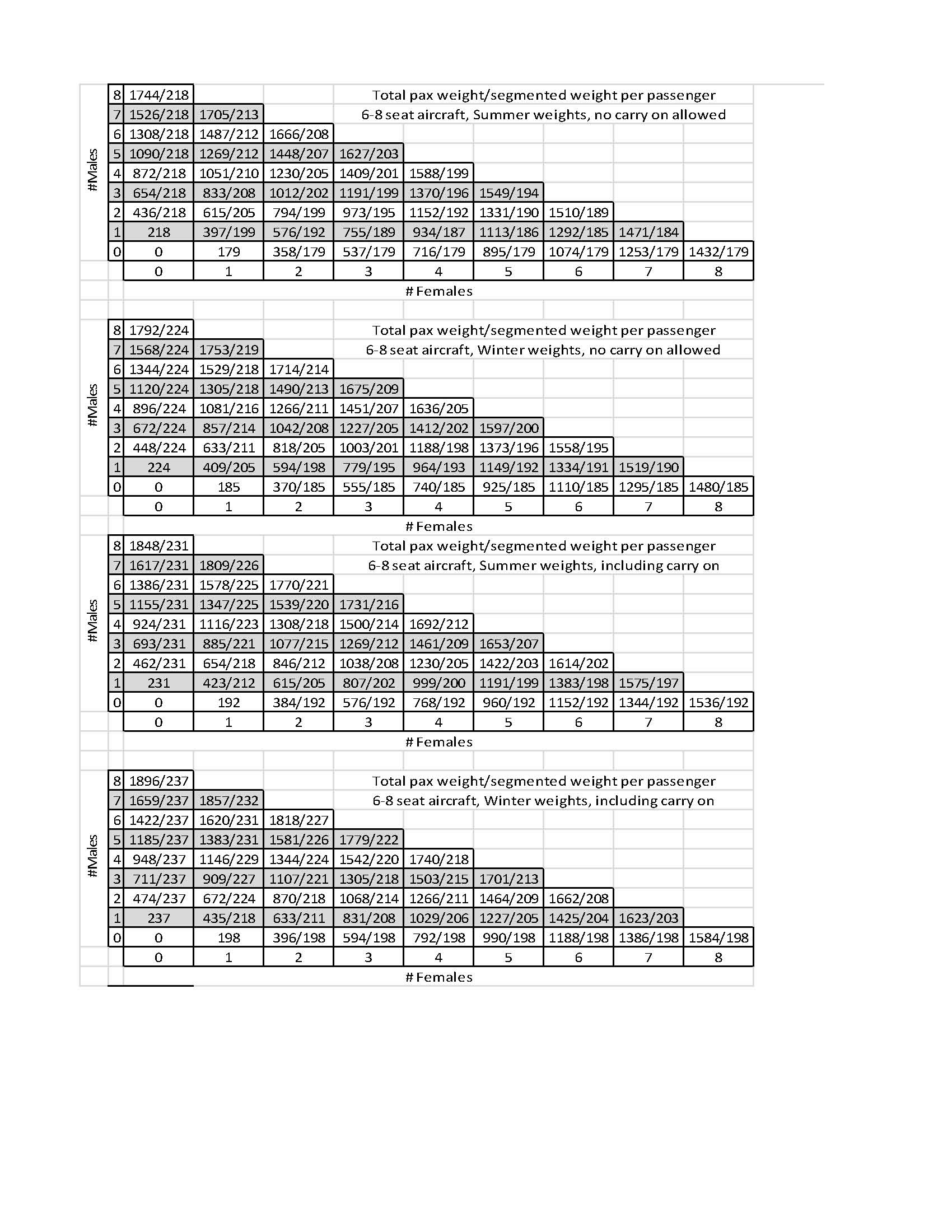

Here is my interpretation of the segmented weights system, using the numbers supplied by TC, and broken down into 5, 6-8, and 9-11 seat aircraft (I didn't bother including more than 9 pax, since that would be beyond the scope of part 703), and each type is broken down into summer/winter, and with or without carry on included in the weights.
Is this how the rest of you interpret this?Re: CAR 703 No More Standard Weights Effective End of July
It seems they have increased the weight of a , " standard " passenger at the same time.

AOW those tables look good, the even account for the male/female ratio. Funny how the table in the appendix A of the circular does not state that carry on is included, you have to reference section 4.3 for that.
I guess it would have been too easy for TC to publish a table like yours.
