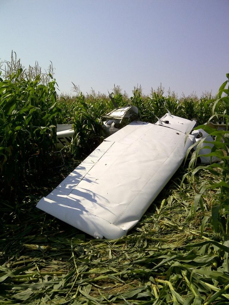

C-FNET Cessna 172S Imported new in 2000 - Waterloo-Wellington Flying Club
TSB Photo

I read earlier that the aircraft was found fairly intact - that pic looks anything but. How fast would it have been going for it to crumple up so badly? And if it was going fast, couldn't they have made a relatively safe landing in the field? Something must've given with the wings or the engine

Ivan42 wrote:I read earlier that the aircraft was found fairly intact - that pic looks anything but. How fast would it have been going for it to crumple up so badly? And if it was going fast, couldn't they have made a relatively safe landing in the field? Something must've given with the wings or the engine
I currently fly out of WWFC and this makes my blood run cold...best wishes to the family and all involved.
Of course in a spiral impact there would be major damage and the speed would have been increasing the whole way down.
If you really study that picture, you will realize that the port wing and port strut have been cut away by the fire dept rescue saws in an attempt to extract the occupants.
Still seeing that the stb wing and fuselage area are much more intact , the damage is consistent with a tight left hand spiral impact but we will have to wait for the official report to be sure.

A 'high speed' impact would have similar results to the College Bonanza that crashed during the night. Not as much was left of that plane...you couldn't even tell it was a Bonanza.
The 172 picture shows the plane pretty much intact, less the wing that was cut away by the fire dept, which does not suggest a high speed impact. The bending of the tail downwards just behind the main gear, with the engine bent up, shows the aircraft hit fairly vertical with a slight nose down attitude, which suggests a spin. Whether it was an intentional spin that was more difficult to recover from with pax in the back seat, or an accidental spin that was encountered possibly during a forced approach is the question.

TSB Photo
