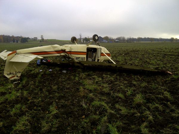

Sorry no details yet, heard aircraft lost power - aircraft is down somewhere in
the Highway 10/Highway 89 Shelburne area.
Tom Podolec at CTV said 4 miles NM northeast of Shelburne.
Update One; said to be a forced landing in a field, no serious injuries, aircraft totalled.
Update Two; attempted to land on gravel road, ended up on it's roof?, two persons
on board - said to be 'minor injuries'.
Update Three; as per CADORS below, overshoot at private field, engine quit, forced landing,
TSB reports no injuries, pilot stated aircraft totalled.
Amended to read 'Private C172D, from Brampton Flying Club C172'

For those interested, here's an excerpt from the CADORS:
Record #29 Cadors Number: 2012O3080 Reporting Region: Ontario
Occurrence Information Occurrence Type: Accident Occurrence Date: 2012-10-18
Occurrence Time: 1550 Z Day Or Night: day-time
Fatalities: 0 Injuries: 0
Occurrence Location: private strip, 4NM northeast of Shelburne Province: Ontario Country: CANADA
Reported By: Pilot AOR Number: 153631-V1
Aircraft Category: Aeroplane
Country of Registration: CANADA
Make: CESSNA Model: 172D
Year Built: 1963 Amateur Built: No
Engine Make: TELEDYNE CONTINENTAL Engine Model: O-300-C
Engine Type: Reciprocating
Gear Type: Land
Phase of Flight: Unknown
Damage: Substantial
Owner: Private
Event Information Collision with terrain
Engine failure
Forced landing
Detail InformationUser Name: Donaldson, John
Date: 2012-10-18
Further Action Required: Yes
O.P.I.: System Safety
Narrative: The privately-registered Cessna 172D aircraft was on a VFR flight from Brampton Airport (CNC3) to a private strip near Shelburne, ON. The aircraft was on approach to land when the pilot decided to conduct an overshoot. During the overshoot, the aircraft's engine failed. The aircraft was flown over some trees and was force-landed in a field, four (4)NM northeast of Shelburne and one (1) mile south of the Mans VOR/DME (YMS). The aircraft was (according to the pilot) "totalled." Two (2) S.O.B. -- no reported injuries. A T.S.B. Investigator was dispatched to the scene.

Re: Brampton Flying Club Cessna 172 down Oct 18 2012
Flooded/stalled the engine with too quick a shove on the throttle? (i.e. accelerator pump)YYZSaabGuy wrote:During the overshoot, the aircraft's engine failed.
I've always hated the accelerator pump. I always push it in too quick and it makes the engine choke a little. (Never had it stop though!)
Your understanding of an accelerator pump is a little mixed up. It's actually designed to prevent the engine from stumbling when the throttle is applied quickly.
Possibly... My understanding is that opening the throttle briskly causes the air-fuel mixture to go lean as the the carb needs time to catch up. (i.e. air flow increases faster than the fuel flow does) The accel pump squirts fuel directly into the air stream to prevent this, but it an entirely mechanical thing, so a very quick shove could dump too much in too short a time. It's designed for smooth throttle opening, and not for getting shoved.Rudy wrote:Your understanding of an accelerator pump is a little mixed up. It's actually designed to prevent the engine from stumbling when the throttle is applied quickly.
I can't say for sure whether the little stumble I get from shoving in the throttle is from over-lean or over-rich, but my gut says over-rich. (I know, I shouldn't be shoving it to begin with...)
BTW, am I the only one who uses the accel pump for a little extra "prime" when starting?
