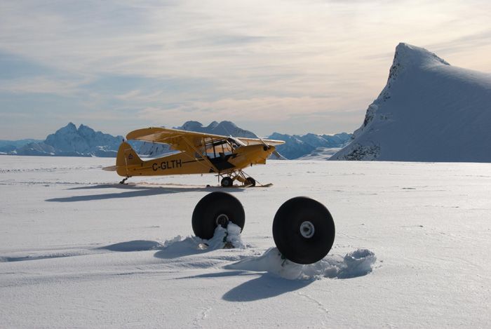

Re: Cessna 175 in Cache County-Utah, Onboard Video
I don't see any skis.
Do people think the laws of physics have changed recently?
