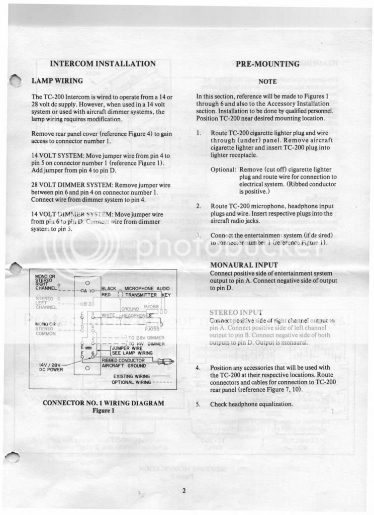

Hello, I have been searching for a way to listen to music through my intercom. I have tried the Inflight tunez patch cable that plugs into an open mic port. My problem is, it leaves the mic permanently open.
While searching on the internet a came across an old advertisement that mentions an entertainment input. I am considering installing a cd/mp3 player in the AV stack. Can some advise on the available inputs on the back? I cannot find any pictures of the back.
Or, can someone advise where the "entertainment" input is? I assume the back. I have no idea what type of input it has.
Thx

Yes, I have wired music into one of these intercoms. I can do some research if you like as to the connections. Post back here if you're still needing information for this....

Yep, still looking for info.

This should be what you need:
