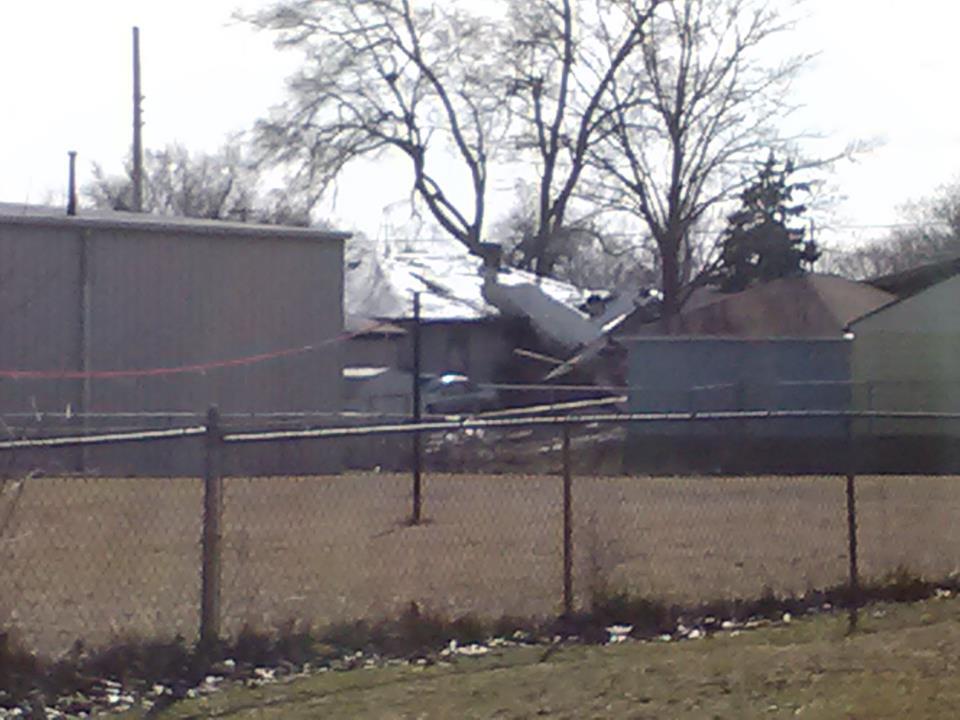

A small jet has hit at least three homes on Iowa Street, southeast of the South Bend Regional Airport.

Neighborhood resident Stan Klaybor says the aircraft clipped the top of one house, heavily damaged a second, and came to rest against a third. He says one resident hasn't been seen.
Our reporter on scene says the plane is upside down on a home.
During a news conference, the South Bend fire chief of training said "This is now a rescue effort," but the search is dangerous because of structural damage to the house the plane is lodged inside and the jet fuel.
Crews have to stabilize the home before they can proceed with rescue efforts.
