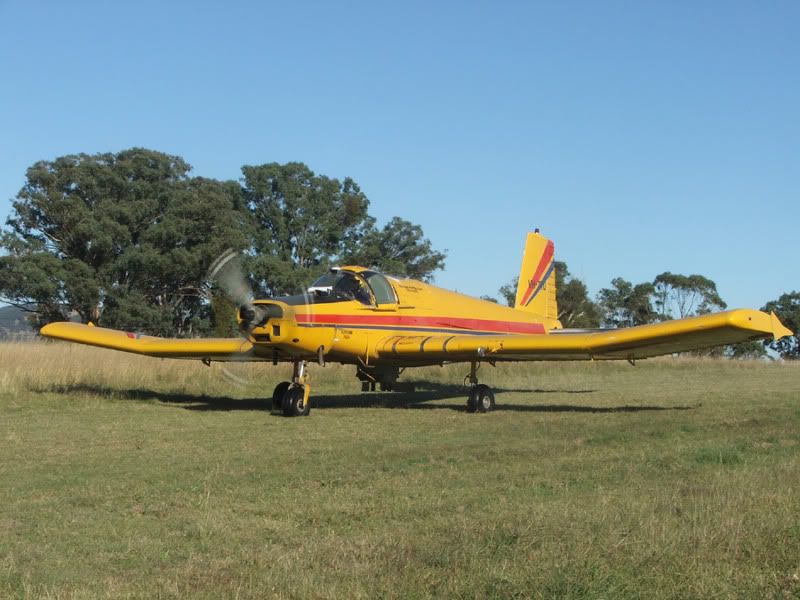

The fore . to the Pac750 the Fletcher is a pretty good short field performer as well. Powered by a 720 lycoming it could out perform a Beaver on most strips. As an Ag aircraft the Fletcher could get 1200 kilo's of fertiliser off in 350 metres at seal level, usually carry a 950 kilo load off a 700 metre strip at 4500' height.
