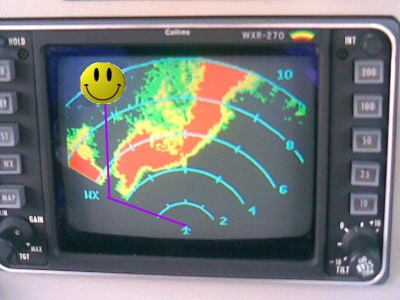

Where is that rule on turns below 400' on an IFR departure? Something about max 15 degrees of bank after gear in transit rings a bell.

Well yes and no. At my last company we actually had an SOP regarding turns below 400 on visual departures under IFR rules and it was along these lines. I remember there being an actual CAR about this or a reference to is somewhere.

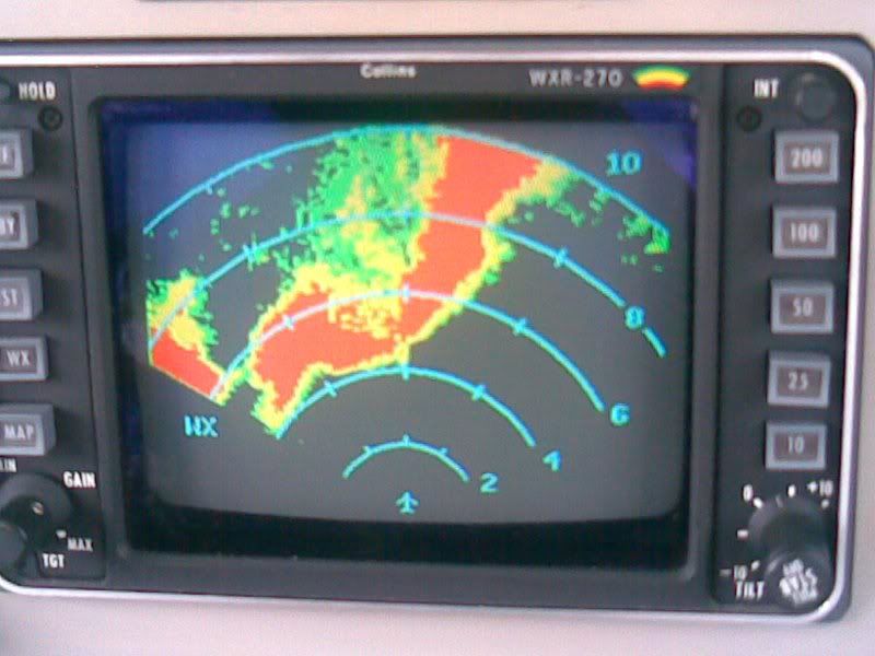

As I thought under 2 b it's there. I was wondering because on dep the other day we were looking at one of these and wanted options other than climbing straight on into it. Another option would have been to delay the departure of course...

co-joe wrote:Wow! You know your CARs!
You know that knob to the right that says gain, if you turn it to the far left all that clutter goes away making the departure safe. :D

Posts: 4747
Thanks ....:lol: that's the best answer yet!
HA! Yeah, and flyinhigh's was pretty good too!
