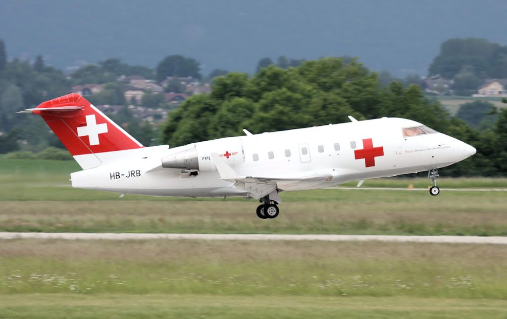

Also Swiss Air Ambulance operated 3 CL-604's
rob-air
Posts: 185
Joined: Sat Mar 05, 2011 6:36 pm
Re: Challenger Québec 11 medevac very close call CYUY
Post by rob-air »
Image[/quote]
Its REGA.They are a private insurance compagny, high end stuff.
http://www.rega.ch/fr/home.aspx

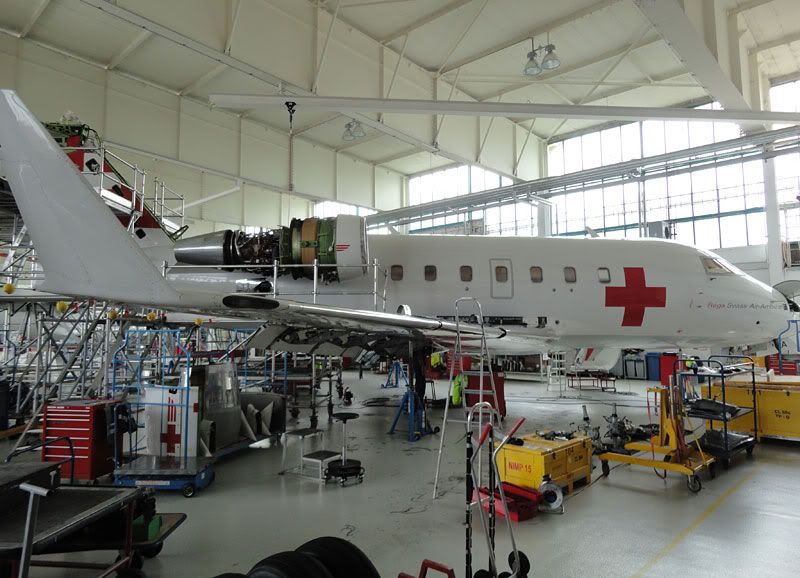

Post by bizjets101 »
Photo off the REGA site, but I liked the caption that went with it, 'During the jets’ stay in “intensive care”, Rega’s aircraft mechanics accompanied the maintenance activities on location.'
